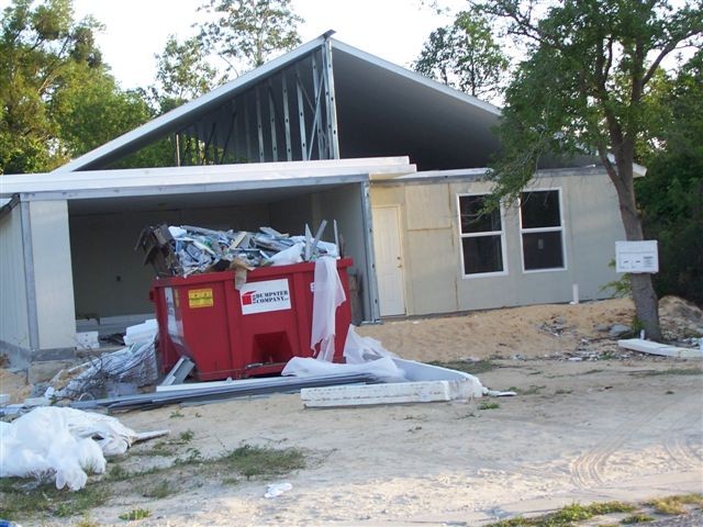

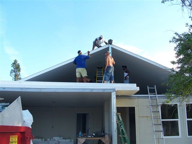

A picture is worth a thousand words... see it going up on my house.
Woody Job, Sanford , FL. 2 story SIP
http://www.ntm.org/don_woody/photos.php?img_id=24183&category=Building+our+house

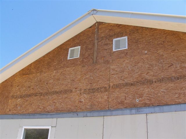

We use a Center Ridge Beam and we use stem walls on both sides of the Center Beam to take the load off of the Center Beam.  The Gables helps to alleviate the weight of the roof only at the ends of the roof.
We also had a house erected in Pt St Lucie, Florida that was a Hip Roof.
Email me for pics.
superiorhometechnology@yahoo.com
Attachment: 100_1894.JPG
Attachment: 100_1920.JPG
