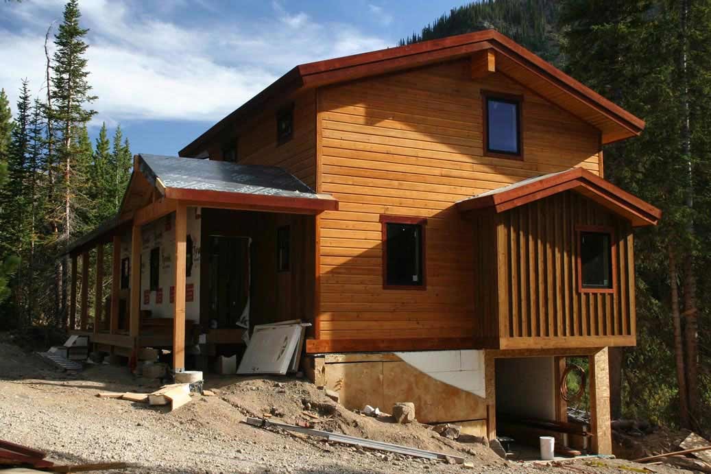

We used lap siding cedar along with some board and batten for accented walls. No furring strips. We put Tyvek on first, then screwed everything into the SIP panels with Deckmate screws of the appropriate color (designed for use with synthetic decks, they will not deteriorate). We caulked all seams and around windows.

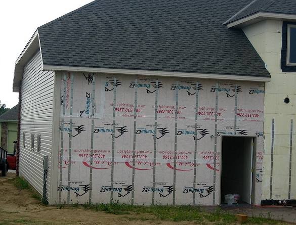

I found this new product that would work great for sip
Attachment: steel furring strip.jpg

23 Dec 2008 07:52 AM
Posted By sidingmaster on 12/22/2008 9:41 PM
looks like steel strapping?

I, also, wish that Sidingmaster would identify the product.
It looks as if it has very regular spots with spacing about the same as the siding's width:  The spots might be attachment points.  If so, it might speed siding installation once it is up.  IF  that's what it is:
How does the time saved putting up the siding compare with the time needed to install the strips? And,
And how many different spacings are available?
