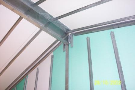

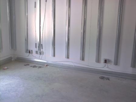

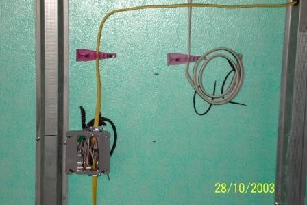

Chris;
You are on the right track.... but first - treated  furring is not neccessary as it does not come in contact with concrete or weather.
1-1/2 steel hi-hat is the better choice @ 24" oc, the less contact with the SIP, the less sound transmission and a 1-1/2" space allows for use of a 4 x 4 x 1-1/2" box w/plaster ring and no skin cutting, no vapor problems and you would need custom size jambs regardless

             the steel hi-hat looks like a very good alternative to what we were thinking of. Must admit, i didn’t think of using steel stud work,  it tends to be used more on the commercial side in the UK, but is readily available.  You have also helped with another problem about the concerns about sound insulation of some sort (or getting an air gap if pos) this system has a few new ideas & advantages on solving this problem.
SIP's is also a new,ish thing on this side of the pond & getting straight honest answers is hard with the limited use over here. But it looks like a good product & it seems most of the down sides is to do with the installers rather than the product its self. But this is the same the world over. :)

a better picture

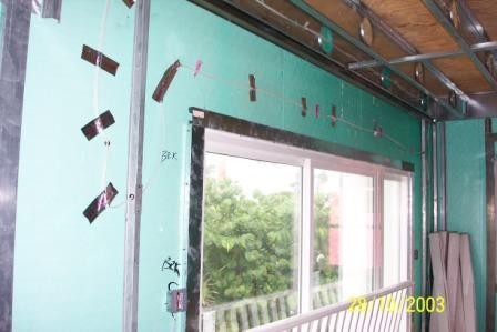

Tim;
Its called draft stopping and we accomplish with a horizontal channel, as shown in photo. It also serves as a continuous nailer for drywall

Chris, how do you avoid code issues with the electrical wiring? The NEC requires the wire to be no less than 1 1/4" behind the edge of the framing member or be mechanically protected. Seems to me a 1 1/2" high hat would be very marginal at best.
dmaceld;
I believe they view the space as a raceway , which has a different set of rules.
Whats worse is the millions of homes built in Florida with a 3/4" furring strip over block
