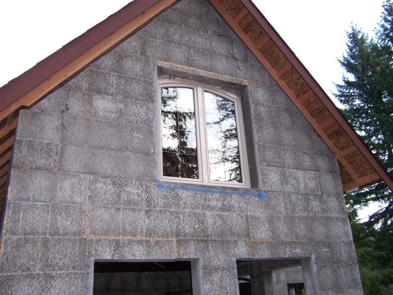

Some of you may remember me hanging out here a few years ago.  I decided to go with trusses and foam on my project instead of SIPs and I don't come to this site as much. I am going through an experience right now that may be of interest to the SIP vs. Foamed Truss questions that come up here frequently.
On my first project, I put in trusses and closed cell foam against the roof deck.  I weighed all the downsides (shingle warranty issues, rot issues, etc.) and sprayed it.  It was an ASTM E-84 fire rated foam and met the code insulation requirements without a fire barrier.  My county inspector signed off on it.
Then, I built my house.  It has 2x8 rafters, again, because the cost and engineering on SIPs was higher.  It also has an unvented attic with foam applied under the roof deck.  And I now have a different inspector.  He says foam won't work and so I have an appointment with his supervisor.  One problem is, the upstairs bedrooms in the house have knee walls and the 2x8 rafters won't allow enough junky fiberglass insulation to meet code. (see the picture)  The inspector's solution was to fir out the rafters a few more inches (then my casement windows won't open completely!!)
Here are the objections (to date)
1) The Washington Energy Code requires that the insulation be in "substantial contact" with the "heated surface."  Even though the attic is conditioned space, he considers the bedroom ceiling drywall the heated surface.  The insulation will against the drywall part of the way, but then up on the roof deck in the peak.  I consider the bottom of the foam insulation to be the heated surface in a conditioned attic.  I asked him if the county had ever approved a foamed roof deck.  He said that the only one he was aware of had to be torn out to meet the county's interpretation of the code.
2) Foam insulation would promote roof rot by not allowing air to the roof deck.  He wants me to put foam panels or fiberglass battens on the ceiling.  Problem is, it's an ICF house with concrete gables.  I don't have any vented bird blocks and don't want to drill through insulated concrete to put in gable end vents.
3) Shingle warranty.  You've all seen this one around, but I wasn't aware that the building department cared.  It appears that my product has a warrantyfor an unvented application in Canada , but is silent about it in the U.S.  I don't care one way or the other.  I'll take $5,000 in energy savings and have my roof wear out 6 months early.
4) Fire protection of the exposed foam in the little attic area.  This is where we started out (he thought up the other objections later).  Several of the spray foams have recently received ICC ES reports that allow attic applications in certain situations without a fire barrier so long as it is separated from the living areas by drywall.  I sent him the reports.  He remains unconvinced and what he says goes.  Because of my design, the "attic" is a 5 foot triangle at just the peak of the house.  I would have to remove all foam that is proud of the 2x8 rafters in order to have a nail base for drywall.  That would reduce my R value right where I can really use it in this design.  Then, I would have to thread slices of drywall up through the collar ties and attach them in a tiny space that I will probably never enter again.
It's not settled yet what I'm going to have to do.  The purpose of this post is just to warn people that switching from SIPs to foamed trusses or rafters may not be as easy as thought.  Talk to the county first.  Of course, it's possible that, had I built with SIPs, the county would be just as confused.
