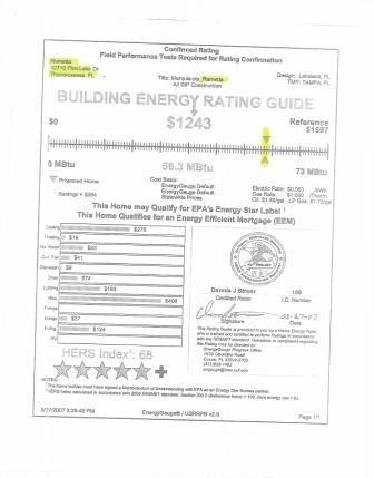

Posts:1649
16 May 2009 11:54 AM
We have all our turnkey homes tested and rated, blower door and duct blaster
Attachment: BoltinHERS.pdf
Attachment: Thermal_Bypass_Checklist.pdf
Attachment: Ramatta Cert2 001.jpg
