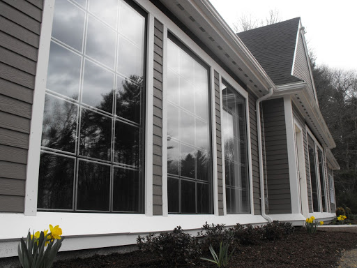

Water filled windows, what the heck is that?
Yes the prototype windows shown have over #3,000 of water in them. The ability to capture heat
quicker than a traditional Trombe wall but the same principles. Not bad looking either Ay! for more pictures of the house click on the picture.
