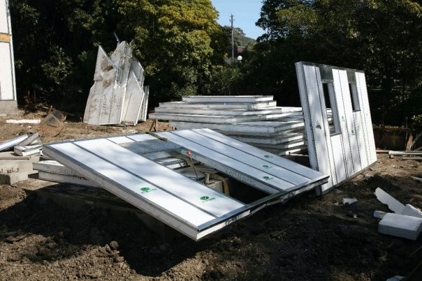

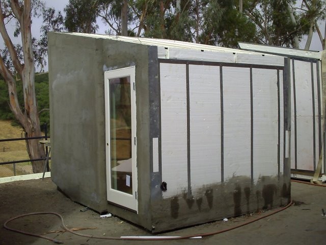

SIP's has become a more broader term than the sips most people think. The old sip's were skinned with OSB wood but today's SIP's are available in many types of skins. There are Systems that you apply skins with screw and nails.
Attachment: _MG_1161a.jpg
Attachment: 2610_58858362257_803707257_1464249_8266441_n.jpg

Posted By ergodesk on 06/29/2009 1:40 PM
ergo;
The definition may be broader in your mind.
nothing has changed,  SIPs still have skins.
Your photo is what we old timer's call walls.
tilt up concrete walls are closer than what you are showing

The pictures show EPS structural panels minus any skins.
you can apply any skin you like, wood, plastic concrete, or yes even metal.

Agreed... Skins applied to these panels are more than double structurally than mechanically fastened skins. GFRC can be applied wet for a super strong skin, when cured can last for 100's of years of maintenance free surfaces.
Attachment: PICT0007.JPG

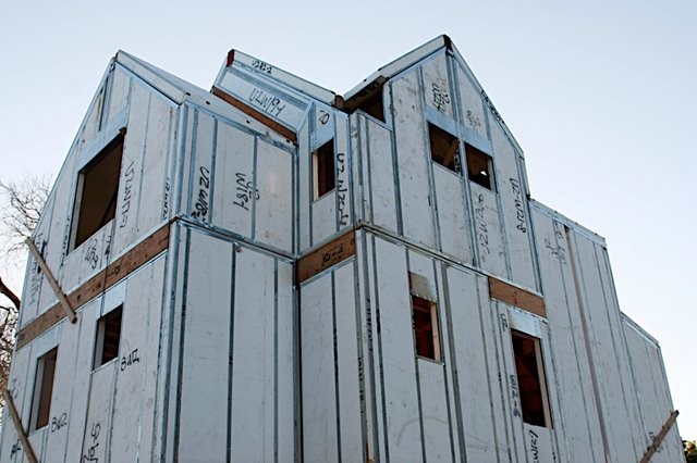

Similar System the different is the company just won some big award or something.
Attachment: gview (1).jpg
30 Jun 2009 07:23 PM
The point, ergodesk, is that system you're showing is not a SIP. A true SIP is a structural insulated panel with the same structural properties as an I-beam, where the foam is analogous to the web and the stressed skins are analogous to the flanges.
Hi jelly, I see you get my "POINT" for some reason many on this Forum and in general think that SIPS are foam cored OSB Skinned Panels, and that not TRUE. The Pics I chose to show here are from companies that list their product as SIPS, and I roll my eyes back into my heads every time I hear it. But these panels are... even though some (Sip Pros)don't recognize the as such they are: 1. Structural 2. Insulated 3. Panels What you really are saying they are not Structural (Diaphragm/Sherewall Panels)see pic. The problem is that everyone is their own expert but have at times little understanding of the materials they are referring., but thats life. Just do a GOOGLE Photo search on SIPS and you will see over 90% Show OSB Panels, and thats what I mean, most have a slanted understanding of what SIPS really are.

What is being shown is a PISF (Pre-Insulated Steel Framing System) and while strong and a product that I have a lot of interest in will not have the lateral resistance that a SIP will have.  If you use the PISF you still have to provide shear panels.  I like the PISF because it has no wood so no termites, no offgassing, no issues with water deforming the OSB as with SIP's but it's definitely not a SIP and shouldn't be presented as such.
