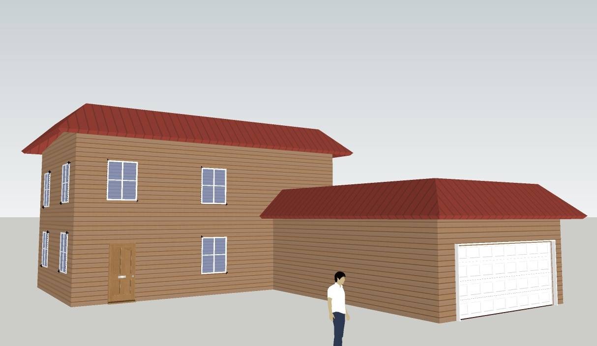

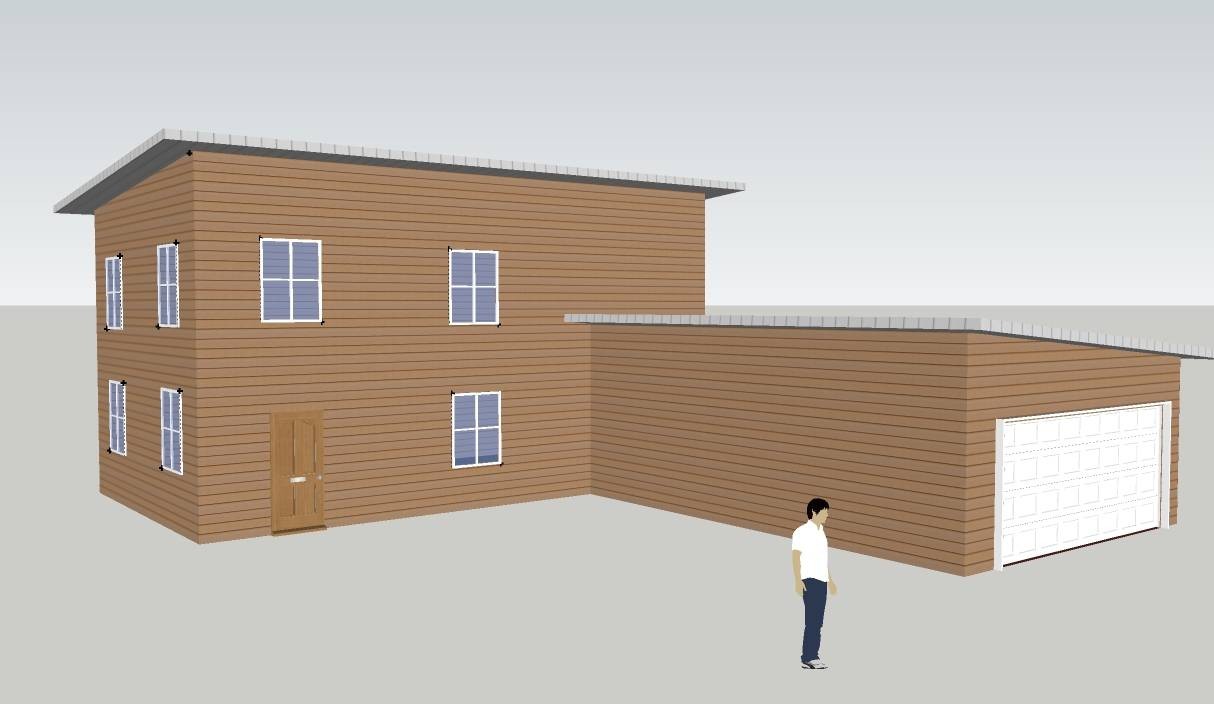

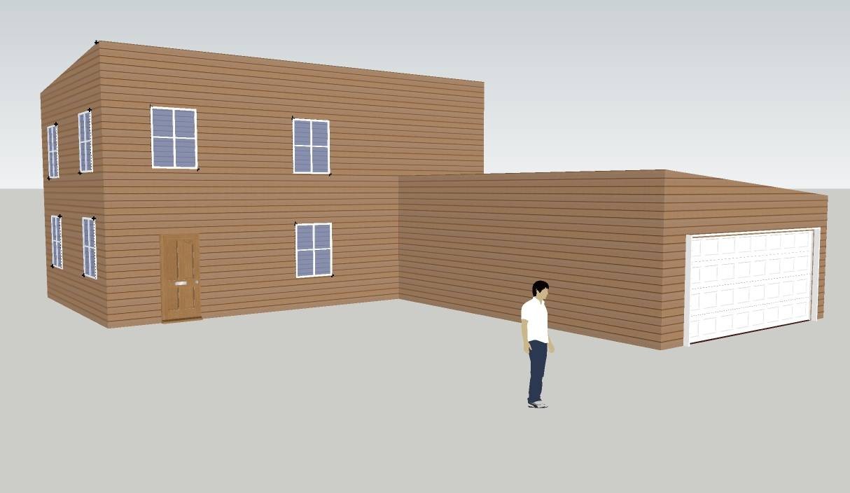

I have been playing around with roof designs in sketchup.
I have attached examples of a low slope roof with superficial roof surrounding to disguise the true roof. Then another with just a flat roof with no overhangs as well as one with 2' overhangs.
Makes me wonder what the price of a superficial roof vs simply overhanging the SIPs by a couple of feet. I am sure the SIPs are more expensive per/ft but more materials are needed for fake/superficial roof.
I think the models are not bad looking. The more I think about this the more I realize that there is a reason many commercial building are built similarly.

11 Aug 2009 12:04 PM
Does the fake roof go all the way around the building?  If so, what provisions have you made to take care of the water runoff from the one way slope.  Does the water have to go between the fake roof and the slope roof to reach the ground or do you have scuppers or sloped gutters?  I am curious because I can not see the back side.  Does the fake roof follow the slope roof or does the fake roof vary in height to stay level?
