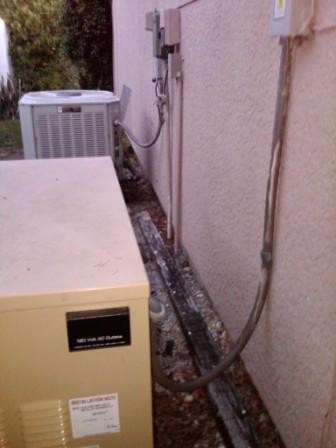

Picture depicts a stand by generator just 16" from a SIP wall, when generator goes thru weekly run cycle it it very loud on the exterior, but in the master bedroom that is only 8ft. away on the interior side the generator cannot be heard.
