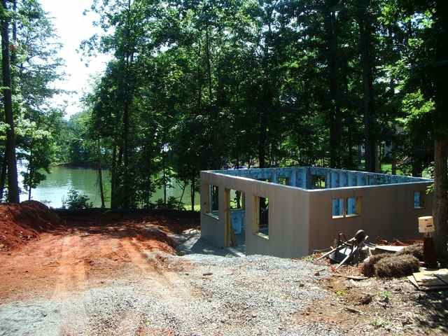

Todd, i think you are the first ICF builder to state that ICF is more costly than ICF. I think Icfs are awesome from what i have read, but i have no first hand exp with them. My superior walls are 7 inch thick at every beam, and 1 3/8 thick between, All factory cured 4000 psi concrete. I sought superior walls out, it wasn't some "Hi powered sales pitch". I planned ahead and ordered my walls a whole month before i needed them. The day the were placed i could have built on top of them. They could have been placed in the rain or in the cold. Can you build on top of ICF wall the same day you pour the walls. If so thats cool. If not i could be excavating while you were pouring walls and still have a green plate ready for framing before you. I would agree that in this way there is no comparison.
Attachment: View from driveway..jpg

I have to add my two cents worth. Unless there is more to the structure that I can't see, we could have excavated your job in the morning and had the footings poured that afternoon. We would start stacking blocks the next morning. We would pour the walls that afternoon. I would prefer you not to start building that day but since its only day 2 in the afternoon it shouldn't be a  problem. There is probably not a big difference in the price but superior walls have one huge disadvantage....last minute changes. We have on several occasions made floor plan changes, even gone from basement to crawlspace after excavating. That has happened a couple of times. What do you do with the walls that have already been built and paid for? A built on site system has the ability to change and we are faster hands down.
24 Feb 2009 08:03 PM
Thats all the first floor, 20 by 28 exterior. Downsizing and getting by with less space was probably the "greenest" thing we have done yet.I just assumed you had to wait for the concrete to cure in the ICF before you could build upon it. Theses walls are the first of three floors. The day the walls were set we could have poured our slab, next day set floor trusses and backfill and keep going up. I am building in my spare time so its going slow leaving lots of time for planning. I am going to use Sips for the next 2 levels, Total 33 feet to the ridge. Change orders cost time and money for sure. How long after the pour would i have had to wait to set the rest of my structure with ICF. Thanks

I agree with last statement,most house we compete against superior walls are plane boxes or just basement walls, like I sayed we are always neck and neck, except on the footings. But if you compare what you are getting, icf is the better choice hands down. Most of our clients are home owners , buiders, that want icf not only for the basement walls, but first and second floor walls also.They already know the advantages , and incorporate icf for the whole project structure, not just basement walls.
BRAWLER, from the picture this is a very simple project, we could have completed the whole basement in a matter of days with a thre man crew..The footings/ inspection 2 days, walls stacked and poured 3 days,thats week #1. the following week waterproofers and slab prep 1 day, basement slab 1 day, thats 7 days total if evey thing goes on track.Were ready to start framing.So if we got the go ahead at the same time as superior walls, you would still be waiting! My framing crews would have you in the dry in a months time.I'm not trying to down you for your thoughts , I'm glad that you are building your dream home.Orangized crews and subs make the difference for any job.

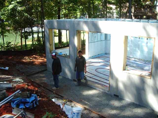

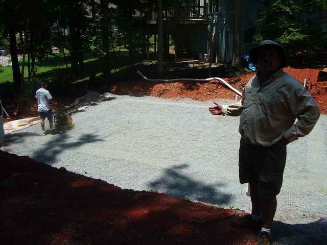

Ikazonov, Thanks, and i am very lucky i got my financing before this all came to a head. I designed this house to be as efficient and as green as i knew how. A big part of that was to minimize the use of lumber and concrete. ICF contractors My walls were designed by an engineer to use enough concrete and steel for the job. I am backfilling only to 6 feet and only for a part of the wall. Time was not a issue, I was able to use my skid and dump to prep the site, I am within 45 miles of the factory, I am leaving the exterior broom finish on the superior walls and simply painting them which will save $ and give us the look we want. The superior walls crew was on site less than 4 hours which my neighbors appreciated , I have gotten swift responses to every question, even after they had my money and have yet to see any horror stories involving SW NC. I used the Sealing agents to waterproof as i would have with any wall. When i see posts from SOME icf contractors that are obvious attempts to distort the truth (lie) i wonder where the rest of the honest contractors are. If i saw someone say something like Superior walls are 15 inch thick and cost less than block I would correct them. Again i have never said anything negative or false about ICF, i think they must be great from all i have heard. When i hear a statment like SW cost twice as much and are 10% the strength of ICF, or SW are 1" thick and no one but me a layman calls BS it makes me question the value of these forums. Ya dont drive nails with a screwdriver, every job has a tool. For my job ICF was not the tool. No fault of ICF. After following this thread i can only conclude that the facts dont matter to Some of the ICF contractors posting here. They will make any claim to slander SW. Show me proof where SW peoduct and not installation was the problem.
Attachment: My buddy smiles displaying the site ready for the
Attachment: basement before slab.jpg
