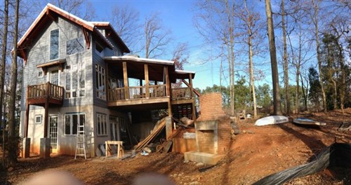

Arcamm, I am very pleased with my Supeior walls. If everything would have gone as well as the basement walls i would have been in the house a couple years ago. As it is i am only a week or two away from a C/O. I believe i used r19 or 24, cant remember to fill the bays all the way with insulation, spray foamed all the corner joints with a DIY sprayfoam and sprayfoamed the rimboard on the open web trusses that sit on top of the walls. i used 5/8 water resistent drywall everywhere to make hanging pictures and such easier since the studs are not as easy to find and hang too. I also used greatstuff to foam the seam between the sill plate on top of the wall and the wall itself. Overall i could not be happier with my basement bombshelter. I will add photos if i can get it right.
07 Jul 2012 12:16 PM
javascript:amaf_insertHTML('%3Cimg%20src=/DesktopModules/ActiveForums/viewer.aspx?portalid=0&moduleid=369&attachid=3491%20border=0%20/%3E');amaf_toggleInline(3491,7093,0); Photo from this winter
Attachment: 2012_pano.jpg
