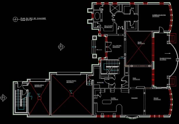

I'm building my next house ( ICF )myself with the help of my 2 hockey teams which includes
almost all of the trades. I find that it is difficult to find "free" advice when you're a self-builder and
specialy if it's ICF...
My Problem right now is  choosing the kind of heating i need for my house... My present house is a bi-generation house
with everything in double.. W/D - DW - 2x60gallon - F/S all of it !! the basement is made of ICF, the walls are 2x6
with all the works: NovaBrick, tyvek, aspenite,fiberglass,reflecting paper, 20mil barrier and finally the gyprock.
The windows are Low-E double thermo with argon and the roof insulation is a good 16 inch od cellulose.
With everything in double + , 4 tv running 8+ hours a day, 4 computer on 24/24 and heated with baseboards
the garage kept at 10 celcius AND living in Quebec.. my annual electricity cost is 2808$ @ 9.6cent a KW
My next house is around 10400sf including garage and rooms under the garages and basement ( plan included )
I got quoted 17000$CAN for a 25w ( 5 ton ) electric heater furnace with 8 ton of ducts with installation, humidifier
air echanger/heat retriever and something else i dont remember...
I know it's a good price but like the guy said it will not keep the basement slab at a confortable temp. He suggest
a good carpet....
I'm looking into Radiant hydronic floor, but since no one can give me some sound advice in what I actually need ( because it's ICF
and it's not really known around here ) i'm a little overwhelmed. Plus, integrating the pex in the basement slab is fine, but the
idea of doing myself pours at the 1st and 2nd floors kinda gives my the jitters.
Any ideas as to what is better for my house? Heat Pump, Electric furnace, radiant.... ?
Francis

Francis,
You will find that radiant heating is king. You will love it. And, if you don't have access to natural gas, they do manufacture electric boilers.
The big question is: Do you require air conditioning?
Also, what you'll need to start with is a Heat Loss calculation. This will tell you how much heat that you'll need. For above grade areas, your floors will need to be engineered to handle the extra weight of gypcrete or light weight concrete. There are also other non-concrete products that will allow you to install radiant above grade. Warmboard is one such product. If that isn't feasible, European style baseboard radiators are very nice. Check out Runtal.
If you don't go with a forced air system(you'll like radiant better) you'll probably also need an ERV/HRV to supply you with fresh air.
Good Luck!

19 Apr 2007 07:34 PM
Now, why would a staple up system in a joist bay be a first recommendation for a "low temperature" radiant system?
In an ICF house, it may be low temp, but this floorplan has some serious glass in it. I see a couple of rooms here that may very well require supplemental heat, even if this is ICF, in this climate.
Also, if rooms are only to be heated a couple days a week, a slab radiant system is a horrible idea. I would pipe the concrete anyway for a future day when consistent heat is required, because pipe is cheap (and I'm biased) but heating up a mass of concrete every week just to let it lose all that heat at the end of the weekend would likely use twice as much energy as you would otherwise need to heat the basement. I would, as another poster stated, consider a good carpet. When consistently heating a space, slab is great. Not so great for periodic use.

Rob you are right about the glass in the house, we are getting some windows removed from the plan. Architects if not givin' limitations
in drawing the plans and budgets, will go nuts on you lollll... Dawn, The 3300$ sounds steap considering its geothermal. Can you break it down a little?
We're are not A/C dependant in the summer.. except for a couple of days. We will not be heating the garages and after checking our Top Hydro rate is
7.3c ( 5.6c first 50kw )... We got suggested by arit a 4 ton w/w and 3 ton w/a. radiant basement slab and joist heated radiant with plates for the main floor.
