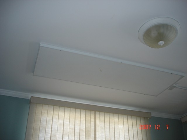

Using electricity to heat can be costly if using the old resistant heat like baseboards. Check out ceiling mounted electric radiant heating panels. They use new technology to heat using long wave infrared.
Zone heat the house, no floor space used, no maintenance, doesn't dry out the air. Very efficient in using electricity. I have used Solid State Heating in CT (Made in USA!) link
There is another ceiling mounted radiant heating outfit in Wisconsin- Radiant Electric Heat. Works well in glass sunrooms too, the infrared heat bounces off glass.

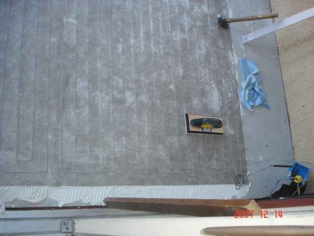

If I'll go with radiant floor, this will be only on the concrete first floor, with PEX tubes inserted while they put the concrete.
