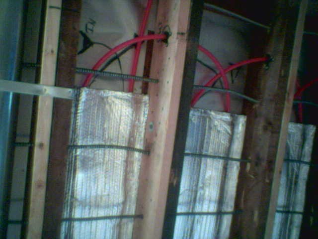

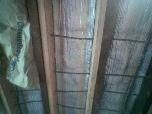

I just put in under floor radiant heat and I used the Low-e foil insulation. It should be about 4 inches below the pex tubing.  The idea is to keep the joist bay air completely static. With the air space your R-value is about R12 (insulation itself is R2.9). You can also add reg fiberglass under the foil.  The folks at houseneeds were very helpful.

I used "only" the staple up and have wonderful results! I used MicroFoil stapled it to the bottom of my floor joists, used the 4 foot wide with white backing. It was very tight, has patented self sealing tape on both sides. I used my home as a test case. I put it in 3 rooms. one had hard wood, one laminate, one a pad with wall to wall carpeting . All were done with 2 x 6 so I had a 5 1/2 inch air space then stapled up MicroFoil. All rooms and floors are toasty warm!

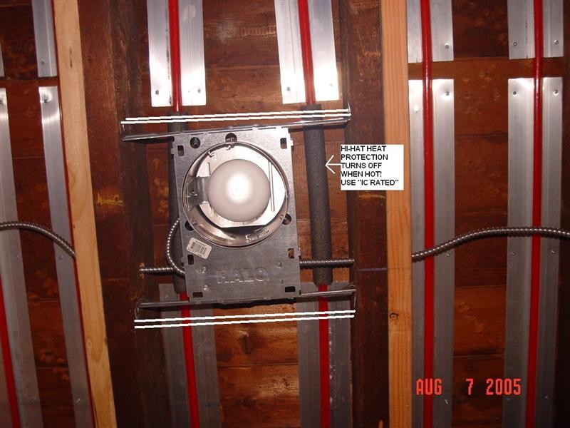

Make sure use use "IC" rated hi-hats and insulate the tubes (Black pipe foam) only as you pass your hi hats! Your lights will turn off constantly even using cfl's due to the temp. Yeap that sucks! Amityville horror ha... "Read your HI hat temp shutoff".Yes SOME electrical lights (UL rated) will shut down to prevent fire... Not some others from China. I know you can use non IC too but why? Don't chance ripping down your sheetrock TYPE X get IC rated! USA MADE!!! If you live in a freezing climate like NY or have a high heat loss BTU/Hr/Sq.ft do this. Why? because you will need to crank up the temp that's why.

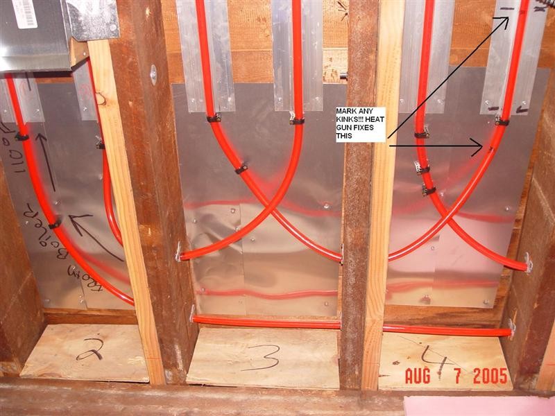

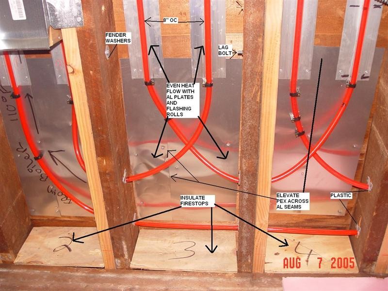

Always use plastic copper tube inserts so that expansion and friction won't scrape your pex against wood. I may be dead when it happens but it's great practice. Usually Black plastic hangers 1 1/4" w/ 5/8 id.
Where the joist trak ends ...cut thick/(thin ok) alluminum plates so that so that your PEX turn will be evenly heated also. Again heat transfer- Physics 101 keep it moving. "The goal is to have the entire Joist Bay a even and better conductor of heat!"

Always go as close as possible spacing wise. Supply windows/doors/heat loss areas then middle of rooms. never go closer than 4" to your OUTSIDE walls/ Joist bays. Label your supplys and returns!! One contractor feed his return and returned on his supply line. Really F uped. Always send the hottest supply to the biggest heatloss..windows/doors...then go inwards.

here's a few pics before the insulation and AL wrap spaced 5/8" AIR GAP.
Attachment: small_hihat heat protection.JPG
