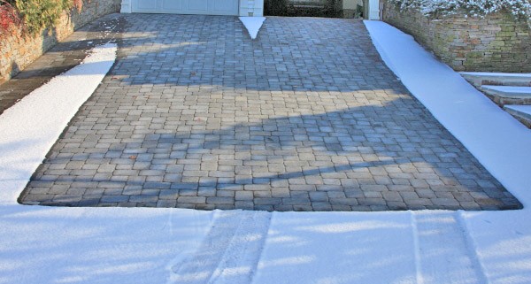

Attachment: completed.jpg

11 Mar 2008 09:34 AM
response time is highly variable, depends on the mass of your emitter, output of your heat source, density of your pipe, temperature of your water.
ICFfamUser is Offline
Posts:69
19 Mar 2008 08:12 PM
WOW...that is a NICE picture. It was a really, really good idea to use brick, too. Not only does it look good, but you can obviously get to any breaks later. What's the substrate? My electrical cost during the winter is $0.03103/kwh. Can you tell me what the operating cost/hour would be to run my setup all electric for 1000 sq ft?
warmsmeallupUser is Offline
Posts:131
19 Mar 2008 08:30 PM
The substrate is a 6" compressed crusher (no insulation) and the 1" of sand. The elements are set at 4" spacing in the 1" of sand just below the pavers. A 1000sf system of the same design would cost $4.99 per running hour @ .03103/kwh. If it snows for 10 hours, the system would be on for 15 hours and cost about $75.00 to run. The extra 5 hours is to allow the remaining moisture to evaporate to prevent it from refreezing.
