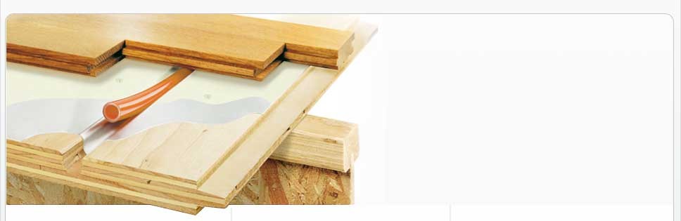

I was wondering if 1/2" ripped and placed to form channels with the channels lined with a thin formable layer of aluminum ( a thick version of foil) would be efficient.radiating the heat as well as Wrapped around and in direct contact with the PEX and overlapped onto the top surface of the subfloor directly in contact with the bottom of the finish floor. The warmboard uses aluminum on the bottom UNDER the plywood and loses in passing the heat thru the ply. If you found effectively a thicker version of aluminum foil applied this way I would think it would work effectively and be cost efficient. The end result would be a foil coverd sub floor transfering the heat to the finish floor as well as reflecting the heat upwards.

I think that you have an  incorrect concept of how warmboard works. Look at the attached picture. The aluminum is direcly under the  finished floor. The heat transfer does not have to go through the plywood.
Attachment: warmboard.jpg
05 Apr 2008 03:38 PM
Posted By Vinmeister on 04/05/2008 2:29 PM
Everything that I've seen shows the aluminum on the top of the panel. Other than cost, the biggest downside that I see is if it gets wet, it would be very slick.

HaHaHa, I guess that I wasn't quick enough!

05 Apr 2008 03:47 PM
my apologies I named the wrong product the product I saw was 1/23" thick with a plate on the underside almost like a roll out type thing.
