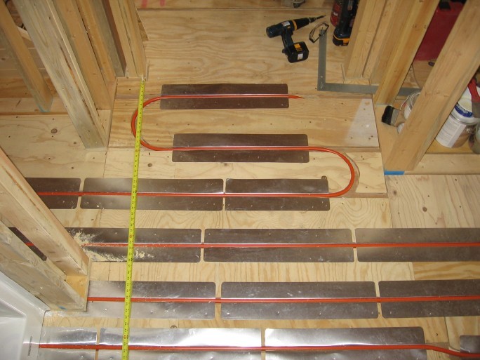

typically if you want to DIY a method, you do what's called a "sandwich", which is strips of plywood infill, with aluminum plates and PEX-AL-PEX. that is a lot cheaper than warmboard, and you sacrifice some performance and work a lot harder to get it in. but when labor is cheap and performance doesn't have to be top of the line, it's a fine method.
You can emulate things like quik trak as well, though in that case you aren't saving much money over regular sandwich and you are crippling its performance compared to an over-infill plate sandwich.
picture attached. Some have used routers instead of strips, but I can't imagine any case where that is really quicker than a "strip production" situation. But, I'm not big into carpentry myself and carpenters disagree. so evaulate as you will. |
Attachment: longsand4small.jpg
