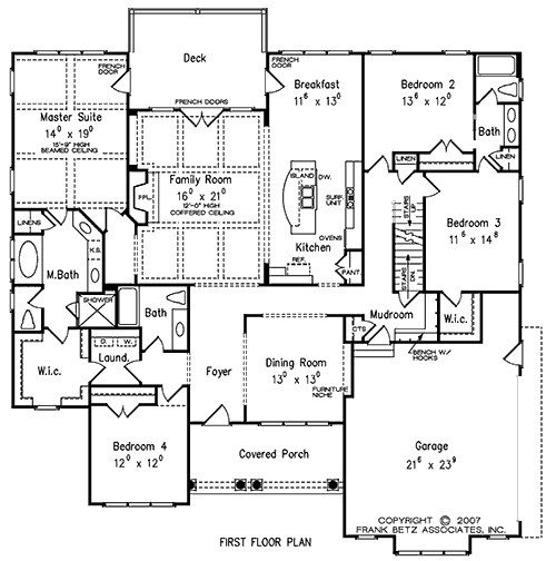

PS: It means nothing to anybody else but us, but I've attached a copy of the Frank Betz floorplan we're going with - it's the Durham Hills design.
