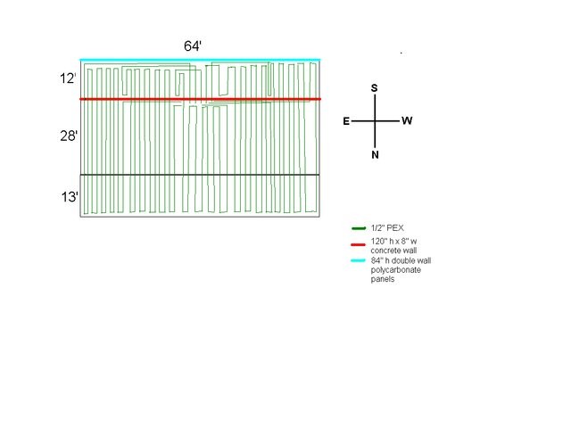

-I would like to use pex tubing to help distribute heat from the concrete pad in the greenhouse to the rest of the lower level slab for thermal storage and to heat the shop (I have included a rough sketch of the design to help illustrate the idea)
     -Will this be effective or not?
-Would it be worth the effort to build solar collectors on the trombe wall, and install radiant floor in the upper level with a sandwich/plate installation, to help heat in addition to the passive thermosyphon?
-Should I insulate the lower level slab, or use the earth as more storage since I am using solar?
Attachment: passivethreadquestion.jpg

The use of pex sounds good if it is needed.  Might not need it.

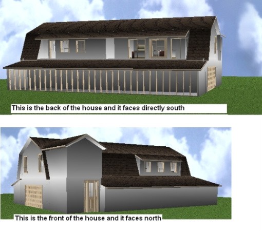

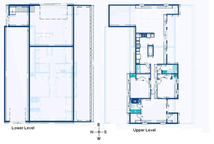

Here are the plans.  The greenhouse will be treated as a completely sealed off area from the rest of the structure, except for vents that can open and close.  I can also adjust the overhang on the shed roof that covers the back bedroom, to provide summer shading.
Attachment: barn3.JPG
Attachment: floorplan.JPG

That helps some. Can you size them bigger I can't read the plan at all Never mind now they the right size
Carlo<br><br>
Naudi2uUser is Offline
Posts:49
25 Jan 2009 01:01 PM
Looks good the plans help alot,
The pex layout in garage should be on the return of the loop to keep it from be cooled before reaching shop/basement.
My only other concern is the bedrooms. The main living ares have more glazing then the Master and North bedrooms. The south bedroom will receive the most passive per SQ ft , main living area next, master bed, and lastly the north bed room. Many passive designs try to equalize the glazing per sq ft to give equal temps.
With all that green house. I think you should not have a problem heating during the daytime, just minimize the heat loss at night.
Thanks for the tip on the garage pex, I completely overlooked that.
