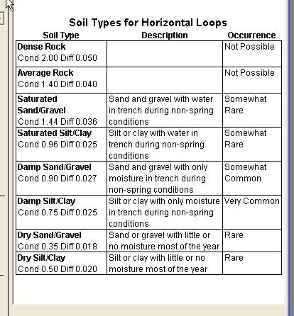

There's something I'm wondering, If poor soil requires more pipe surface areas in contact with the ground to get the same heat transfer as a loop with less pipe area in better soil. Than if you were to dig your trenches and back fill them with the ideal soil, would this allow you to install smaller loops than you would normally require than just reusing the original soil you removed? Or would the surrounding ground in contact with the better soil have the same heat/cold transfer problems and when the system is in use you could wind up with better soil frozen into a block of ice from extracted heat?
If so, Im wondering the cost of delievering the better soil would eat up any cost savings you would gain from being able to install shorter ground loops.

As the attached table shows,  the moisture content of the soil plays a bigger factor than the type of soil.
Dry sand/gravel has a thermal conductivity of .35 Btu/(h*ft*°F) the lowest rating on the table.  A 5 ton unit would need 6520' of 1" slinky pipe in 815' of trench in this soil.
Saturated sand/gravel has a thermal conductivity of 1.44 Btu/(h*ft*°F) the highest soil rating in the table.   A 5 ton unit would need 2400' of pipe in 300' of trench in this soil.
If you hauled out the dry sand and  brought in dry clay you only move from .35 TC to .50 TC.  Not worth the effort.
The best thing would be to keep some moisture in the ground.  The more the better.
