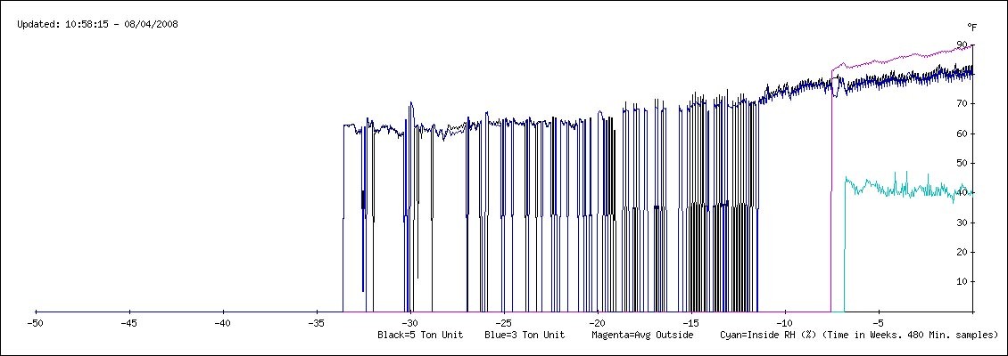

I've got a vertical loop that I'm wondering if it's performing properly.  I'd value some comment, please.

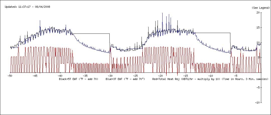

A 50 hour chart of my loop's performance is shown below - it's also at http://welserver.com/WEL0043/EnteringWaterTemps.gif .  On this chart is Entering Water Temp (EWT) and Heat of Rejection (HR).  (Note that you have to add 70° to the chart's EWT numbers, and multiply by 10 to the KBUT/hr numbers.)
(The EWT numbers are 'sample & hold' numbers, to eliminate values when unit(s) are not running - 3 minute sample frequency.)
Here's where I'm confused.  My deep earth temp is 68°F (Dallas).  And I've got almost 1 mile (4800') of 1" HDPE U-Tube pipe in the ground.  Yet still my EWT gets as high as 84°.  (Over the course of a full 24 hr day, I'm rejecting into the earth about 750 KBTU, at a rate of about 30 - 82 KBTU/hr depending on which GSHP units are on.)
And I'm also confused because during the course of a day, I'm seeing an EWT swing ranging from 76° to about 84°.  It surprises me to see an 8° EWT swing during a 24 hour period.
And lastly, I don't understand why, long term, my average EWT seems to track the average ambient outside temp.  I thought that the deep earth temp stays constant, at 68°.  Yet, this chart here, http://welserver.com/WEL0043/EnteringWaterTemperatureDailyAvg.gif , shows clearly that my average EWT tracks very nicely to average outside temp, which doesn't make sense to me since I have a vertical loop.
I'd appreciate hearing your thoughts.

Attachment: EnteringWaterTemps copy.jpg
Posts:2749
04 Aug 2008 02:14 PM
What was your EWT at the very beginning of the cooling season? Fairly close to 68, maybe lower if during heating season you had "stored some cold"
Do you have auto-changeover between heating and cooling such that in the early AM in late winter or spring you were heating and then later that same day cooling? What were your EWTs then?
My based-on-zero-actual design-info hunch is that your loops are working relatively well - your peak daily EWT will continue to slowly climb for the next several weeks and then begin to tail off just a bit during early fall.
I'm not suprised at the daily swing as well - ground within several feet of your tubes warms during the afternoon and cools a bit during the night
All those tens of millions of Btus you have rejected are building up underground. I guess much depends on both your ground's conductivity and any lateral flow in your aquifer(s)

engineer, you're right!  EWT at beginning of cooling season was 67°F - "fairly close to 68°."  EWT wasn't much colder than 68° because here in Dallas we don't "store much cold."
You can see this on the chart below - at about week minus 18, about beginning of Apr.  Chart is also at http://welserver.com/WEL0043/EnteringWaterTemperatureDailyAvg.gif .  We flipped over from heating to cooling - no autochangeover.  You can see the sudden rise in EWT at this point.
Don't have data on how much EWT 'swing' was during a 24 hr day back at this point.  Probably minimal since I'm sure my HR was in the range of 60 KBTU/day, not 10X like it is at the moment.
