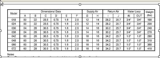

Posts:1609
24 Sep 2008 02:46 PM
A six ton Hydron unit weighs 410 lbs.
The chart below shows the weights  for various sizes

Climate master's similar
Model - BTU Weight - Operating, lbs
026 038 049 064 072
266 327 416 443 443
Posts:4377
25 Sep 2008 12:38 AM
Shipping weight averages close to 400 lbs with packing for most sizes. All are heavy. Ton refers to btus absorbed by 1 ton of ice melting in 24 hours. I know you knew that TG, just threw it in for others.
