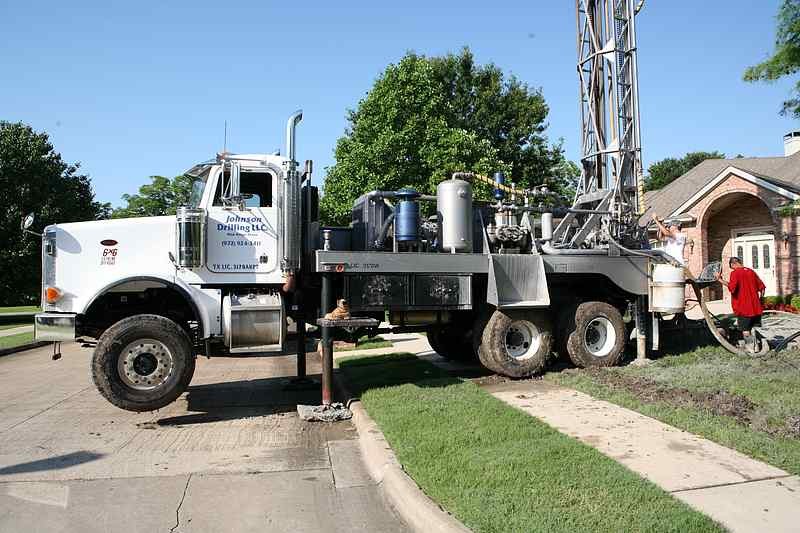

And, would this drilling rig pictured below be an example of what costs about the one-third million dollars you note above?  If not, do you get more 'truck' or less 'truck' for the 1/3 million?

No, a rig like that most likely only costs $100K-$180K, depending on the type of head it has. If it had a sonic drill head, it'd be in the $600K range. The $300K drill that I'm referring to is mounted on rubber tracks, and has a sonic drilling head. It's 6' wide, 14' long, and stands 14' tall. Its primary use would be just for DX geothermal loops (max. of 100' depth).
The rig I have now is 8' wide, 22' long, and stands 28' tall. It's also on tracks, but they are metal tracks. It's capable of drilling down to 500+feet. We've never gone deeper than 300', though.
As far as price variances by region... If the general geologic formation of the earth is consolidated and not cobbles/gravel/loose fill, then a truck rig like the one in the picture will work fast and well. If that's the case, they can afford to drill for a lot less, because the overhead of the thing is considerably less. Most of Utah/Colorado/Wyoming/Idaho SUCKS for drilling. It varies so much from one hole to the next, that you can't rely on being able to complete enough holes fast enough to make such a truck rig work.
