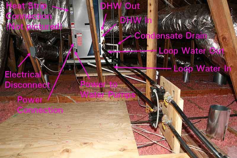

Hi all, longtime lurker, first time poster. Could some of you please post pictures of the piping and electrical connections around the furnace? I want to compare to the layout of WF envision installation, there aren't really "real world" examples, just the diagrams, which I don't think depict an accurate view. It looks abit messy, but theat may be compared to a std. Forced air furnace in my mind. Thanks, Rob

Here you go.
WaterFurnace Envision 5 ton 2 stage variable speed GSHP unit, without DeSuperHeater or Aux Heat (strips) connected.
Attachment: IMG_9917diag.jpg
