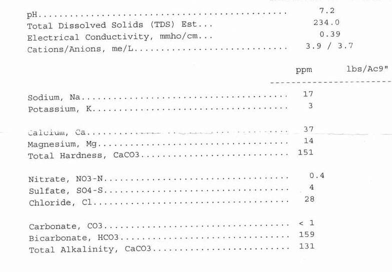

kwebberUser is Offline
09 Oct 2008 02:25 PM
Thanks guys.  This idea has my full attention.  I'm having a hard time finding information on what would be considered quality water for this system.  I found the results of a test done in 2005 on my water, but I'm not sure there is even enough information on it.  I have attached it.  Any ideas on where to find information for what is acceptable for water?
Attachment: WaterTest.jpg

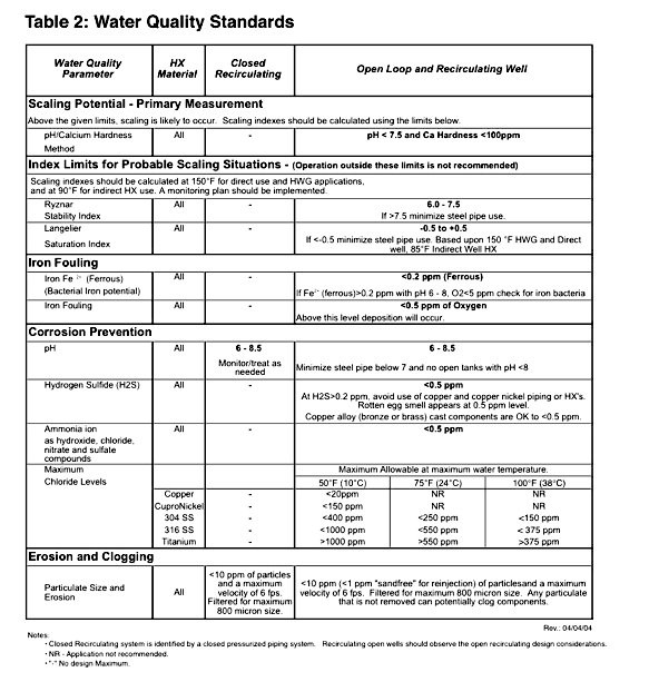

bartman99User is Offline
Posts:57
09 Oct 2008 03:09 PM
This was posted on this forum a while back (I can't take credit).  It's from the Climatemaster manual.
Attachment: water quality.jpg
09 Oct 2008 03:46 PM
Thanks Bartman, looks like my hardness of 151 may be an issue. does anyone have any thoughts? I checked my well this afternoon, it measured about 150 feet deep (I think the pump is probably 10 feet up so I think my memory of 160 feet is right), and the water table is at 12 feet below ground, not sure what the draw down would be during pumping. Does anyone have any suggestions on how deep the well should be? 300'-400'-500', I've seen some suggestions of 80 feet per ton, which would be about 400.
