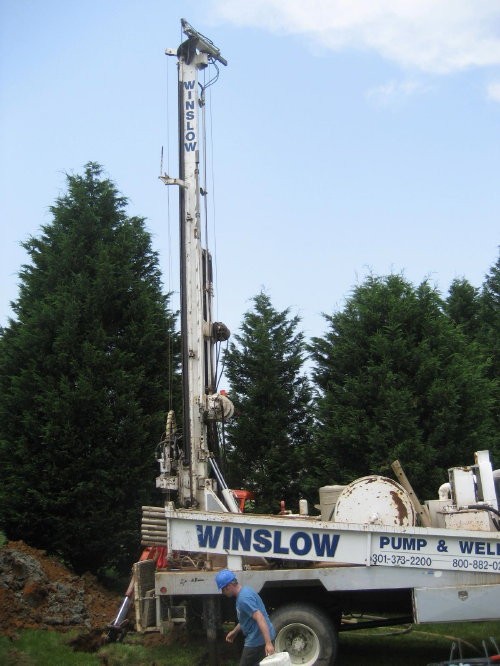

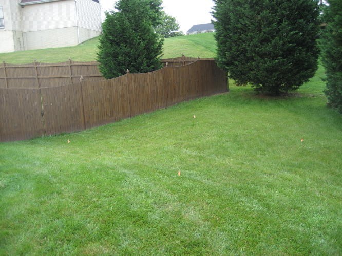

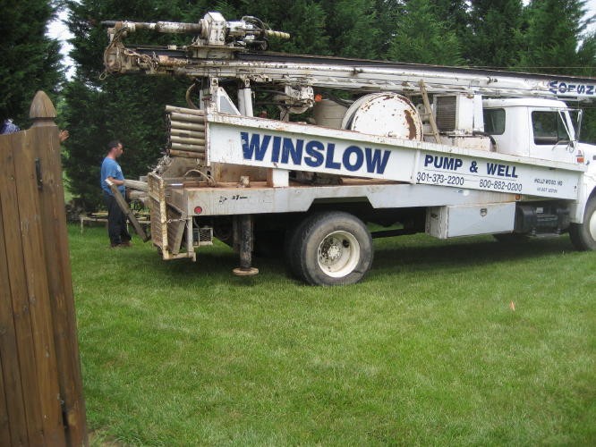

They started drilling  Friday afternoon and just arrive this am (Monday) to drill the 3 remaining wells.   They are really happy with my dirt  ;)  or the lack or rock.   It's about 5 minutes per segment.
I'm not sure if this site allows pics.  Can anyone recommend a blog site or should I just host on a picture site and paste the links?

30 Jun 2009 08:40 PM
How these pics come out ok, had to resize. One well done last Friday, three yesterday and today was connect the pipes, drill two holes in my foundation wall and test for leaks. More pics to come. CH
Attachment: Well_Field_Siide_yard.jpg
Attachment: Driller_Setup.jpg
Attachment: Ready_to_drill.jpg
