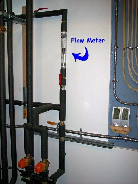

As a new GSHP owner, a flow meter is appreciated. By turning 2 ball valves, I can check the flow rate. As well, my 2 $10 thermometers, give me an indication, (not super accurate I know), of the temp of the water going in and exiting my hp.
Attachment: Flow Meter 95.jpg

I Love the picture of the piping in the post above it looks GREAT compared to mine.  The following quote is very applicable to my piping.  An EXTREMELY heavyset plumber was trying to lighten the mood on a particularly difficult job site and told me ...  " I may not be fast, but when I get done it sure looks like !!"
