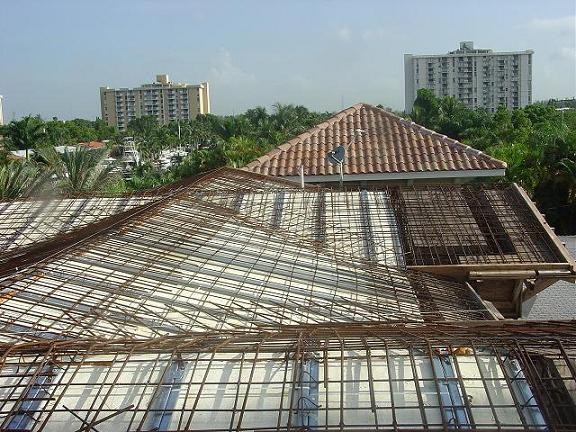

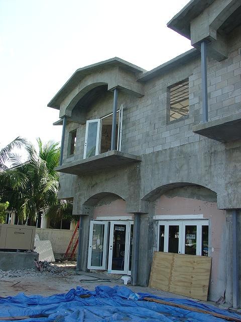

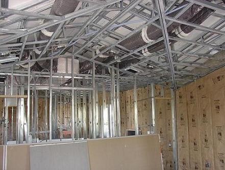

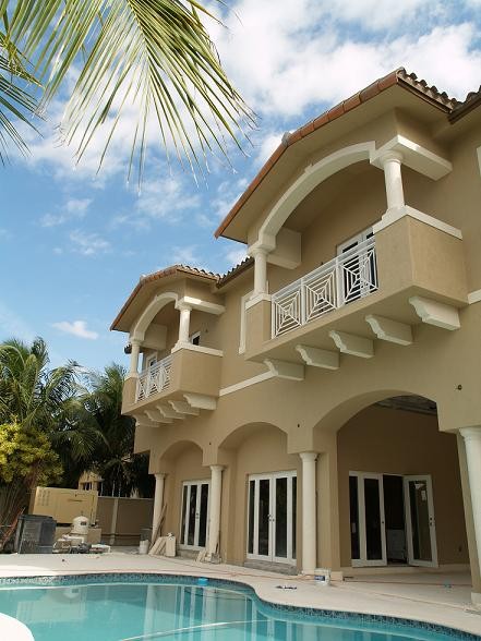

This could give you some ideas. This is a 2,000 sq.ft addition (2 story) on the back of a 2000 sq. ft house. The floor and the roof are poured reinforced concrete over WRCS insulated forming panel system. The panel price includes the structural engineering and shoring design on the roof and floor.

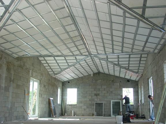

This is what they made in the interior, planing to have the cathedral ceiling in some areas.
I will post pics later of ICF walls with this system.
