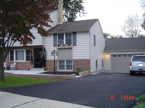

My house sits on a recessed lawn, causing water to run down towards the hose. I poured a concrete patio in front of the house. I even tared the front wall, back filled, to push water away from the house. Kicked out the drains farther, and even poured a small footer wall and added a landscaping stone.
Dont want to do the paint thing. but been seeing this new rubberized paint. It's alot of $$$$ though.
I'll add a pict.
MSBHAMMERUser is Offline
03 Nov 2009 07:00 PM
You can see how the house sits down hill. I even get water on the drive way side as well.
I have no idea where the water comes in at. I actually think that the block fills with water, and then just fills up and works its self around the house.
A cheap fix I guess, but I thought of drilling a hole in the crawl space....in one of teh blocks and adding a drainage tube from the wall to the drain pump hole.
It looks like some sort of french drain was installed. I see new concrete along the inside of teh crawl space. Its really ruff though.

It appears that the area next to the garage is a 1/2 level below the main entryway. Is there basement under the area to the left of the entry? Is this the problem area? Do you have problems with the area next to the garage? Does the yard fall away from the house in the back?
It sounds like a french drain system of some fashion was installed. Does it lead to a sump pump? If not, where does it drain to?
Unfortunately, most of the surface exterior fixes you mentioned will not affect the ground water problems you have. In fact the poured concrete patio may actually make the problem worse. It doesn't allow for surface evaporation of ground water under the concrete, and so this ground stays wetter for a much longer period of time.
Your thought of drilling a hole in the blocks to drain the water is, actually, not a bad idea. But you must drill every cavity of each block, as they are not interconnected. It is part of the remediation process used with the baseboard drainage systems. Check out www.bdws.com.
Without an onsite inspection, its hard to further diagnose the problem and offer any firmer suggestions. Water problems can be the most frustrating things for a homeowner to deal with. Maybe this will help some.

I just built the garage this past year. I added in a drainage system in front of the garage.
The first window along the driveway is a bathroom, and the wall of that room facing the drivay gets water, along with the whole front of the house.
The new pad and walkway was done just a few months ago. It has great pitch and run off.
As you said, it frustrating. Water can be getting in anywhere and just filling up all the way around the house.
Gonna add a porch roof across the front of the house. that will kick the water a bit further away from the house.
