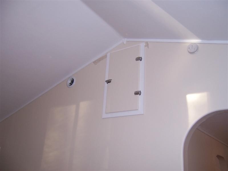

It isn't the construction technique that makes it harder to heat, it's the shape and volume.  SIP construction can mask the effect, but not eliminate it.  A high peaked ceiling will use more energy, period.  It creates a dead air space that traps hotter air that is "wasted" because it doesn't serve any useful purpose where people live, i.e., on the floor.
There are several ways to mask the effect.  SIPS can provide superior insulation overall.  If you have an effective R50 SIP ceiling/roof, there's less hot air wasted in the peak than with conventional construction and an effective R30 roof.  If you have tight construction, it's less likely that you'll have 40 degree air leaking in and lying on the floor.  If you have forced air heat, you may circulate that air and not notice the heat stratification.  Same result with a ceiling fan.  But the physics remain the same.  A high peaked ceiling creates more volume and will have higher temperature at the ceiling, where nobody gets any advantage from that heat.
That being said, high ceilings may have aesthetic advantages that outweigh the negatives.  If you like the gymnasium look or the Montana McLodge look, high ceilings are required.  If the construction is tight and well insulated, you can reduce the inefficiency, but never eliminate it.  It's sort of like when I "hot rod" my wife's Prius.  I get horrible gas mileage.  It drops down to 35mpg.  It's only horrible as compaired to her "normal" driving and 45mpg.  High ceilings will  be less efficient, but it may be something that you can live with.
As to temp differential, when you measure with an IR thermometer, you get a 45 degree slice of what's happening 28 feet above.  You're not shooting just the peak.  It may show an average temp that may be only 2 or 3 degrees higher than the floor temp, but if you were only one foot from the ceiling in the peak, you'd likely see the 8 to 10 degree difference, especially with the fan or forced air heat turned off for an hour.  If you can circulate that heat, you can mask the effect and maybe benefit from the heat, but you're not changing the physics.
My solution was to place an intake for the ERV right in the peak.  When it comes on, it takes the warmer air and passes it through the ERV, which effectively provides warmer incoming air that is distributed at floor level.  It eliminates the stratification without a visible fan.  Can't hear it or see it, but it reduces the heat stratification from more than 10 degrees to a couple degrees.
Mark
