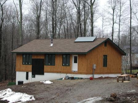

I have a solarsheet 2 panel set up on my house.  It is wall mounted with a separate PV pannel and fan.  It has been installed for about a year.
I can honestly say it is a great product  and puts out quite a bit of heat on sunny days.
I spent one whole day on the instalation to be happy with it.  Part of it was I was attatching it to an ICF basement wall so drilling the TAPCONS trook a while.
I believe of all the things I put in my house this was one of the smartest.  In the picture you can see the wallmount of the double pannel.  The small black pannel is the PV module.  I had a bit of a wierd set up becuase of the wall overhang and could not use the standard set up.
It works best in concert with better air sealing so the space is not so drafty.
Buy it, you will like it.

In the summer you have 3 things going for you ( at least in my case).
First the overhang shields the  solar collector from direct sunlight.  On a roof mount I might just cover them for the summer with a reflective cover of some sort.
Secondly the system comes with a thermostat so if you don't need the heat, the fan does not come on.  Clearly you don't want it blasting heat all day in august.  The pannels are capable of taking the high heat of  direct sun with no airflow.
Thirdly I just closed off the exaust vent for the summer so I did not get any airflow.
The advantages I see with this over a window (no pun intended) is you don't get night time  heat losses and durring the summer you don't get excessive heat gain.  OTOH you can;t look out a solar airheater and it might not go with the asthetics of your house.
