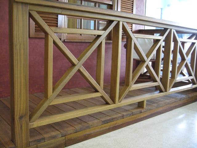

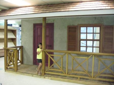

below is a view of their products installed over a SIP display that we precut for them
Attachment: Showroompicfullfront.jpg

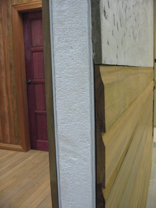

GreenHeart
Attachment: 005.JPG
Attachment: Wallsystem.jpg
