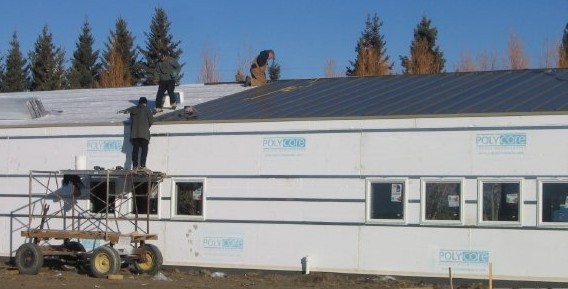

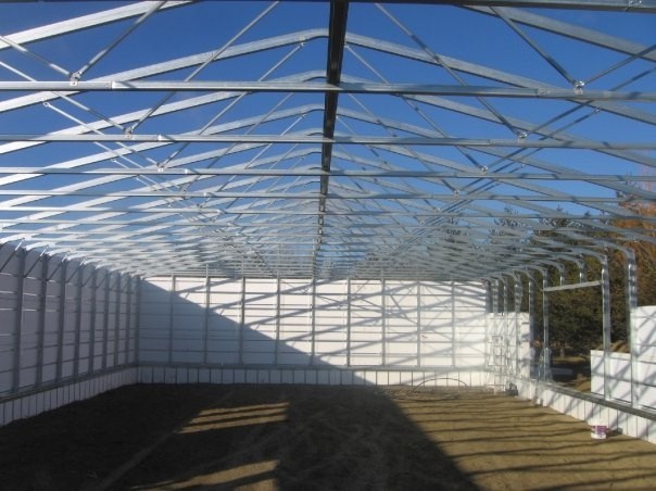

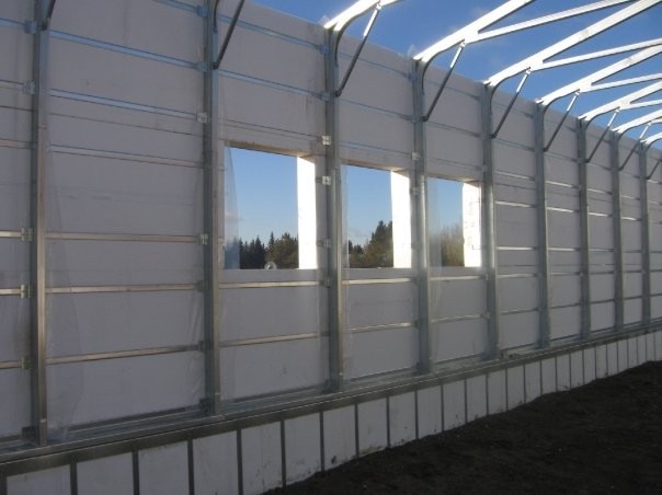

Just completed a 70' x 40' "Versa frame" shop in two weeks, start to lock-up. We used the versa frame as the structural frame for the shop. We then sheeted the sides and roof with 4' x 11' 8" EPS and structural steel panels. The steel embedded in the EPS acted as the purlins and girts and the outside was ready to be cladded. The end product was a R36 insulated shop that was erected sheeted and locked up in less than two weeks. I have attached some photos of the project, if you want more information feel free to PM me.
