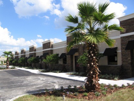

15 Sep 2009 05:59 PM
We are fond of this 14,000 sq. foot commercial office condo, the "no-wood" SIP shell walls and roof , was erected in just 10 working days
Made with 25% recyled skin materials and recyclable skins and EPS core, USDA approved interior skin finish make for a cleaner IAQ
Attachment: Commercial 010.jpg
