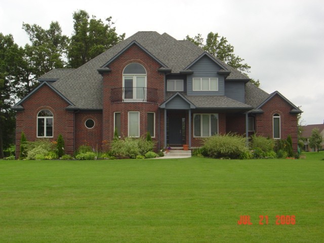

This is a ICF I have owned for a few years now and this a typical heating bill that we see.
The only insulation in this house is ICF , nothing but ICF anywhere. It is a total of 2,600 square feet on 2 levels.
The duel heat line is a separate meter , consuming 280 KWH , Thermostat setting 24-7  is 68 degrees----- $15.00 in November.
See the actual bill.
Eldon Howe<br>Howe Construction
<br><br>Total Concrete Homes provide positive cash flow , DAY ONE .
