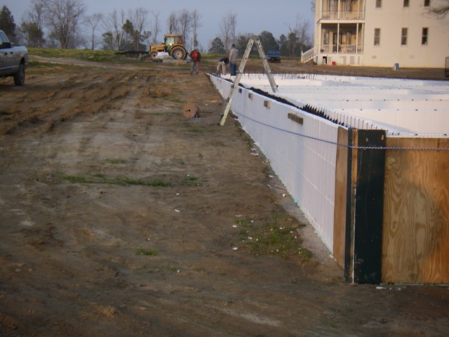

Okay, here it is 36-1/4" out of level, let alone over 20" out of square.

Oh hell, that's no worse than building on rock, at least it's pretty consistant

rock you expect it, I have two rock jobs i did that were more than 20' out of level, this was poured footings gauranteed to me to be level. Worst, they did not finish the tops, each block is scribed.

Yes, a footing you would expect level
Hence my contract and because of the original post above from me
"Footings more than 1/4" out of level and a charge of $ 20.00 per l/f of wall for the entire project is added to the invoice"

No power lines nearby.
BTW had a contact with the guy one particular line in the contract says that we charge $25.00 per 1/4"per 10' out of level on footings. this would have cost him over $80,000.00, and explains why he went cost plus on the contract after signing the contract and one day prior to our arrival.

That's beyond sorry!!! How could you possibly get that far out with out somebody say'n someth'n don't look quite right?
