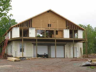

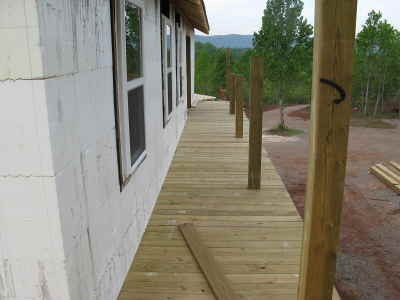

Great Blog!
What we are doing by building ourselves really is showing that this isn't rocket science. Common sense, basic construction skills, patiance and determination is what it takes! Oh I forgot time.......................... Money......................
I had a great time stacking my 600 plus blocks, all the worry about the pour is now just a distant memory.
My next step is installing the metal roof and starting my wiring!
All doors and windows are installed! I also built a surround deck.  I'll be completely dried in by the middle of June.
Keep us posted!

Hey Bill, can you tell me how many people/how long it took to stack your walls?  What you've got in your picture is very similar to what I'm doing (although mine's only going to be about 400 blocks), and I want to do it myself (with [i]some[/i] help), but I'm a little worried about how long it will take me to get to the first pour after my footer is in.
We're in a residential neighborhood on an alley - it's an addition (doubling our Sq/Ft) to be put on the back against the alley.  I'm a little leery of someone (mostly kids really) tinkering with the forms before the fill.  I have 4 of my own, so I know how kids LOVE to pull apart styrofoam!!  :-D
I can put up with a little time, and even a little aggrevation to save the $9,000 labor bill, but I don't want it to take too long, and I worry more about something being "adjusted" the longer it stands before the pour.
Any info will be hugely appreciated.
LANCE
Raider BillUser is Offline
Posts:75
16 May 2008 12:20 PM
The first lift of blocks took 6 days to set and brace it was 12' high. I was working alone. I had all my bucks pre built Re bar was cut and bent I'd say it took me 2 days to have everything ready so I just had to set them in place. I'd say a good 2 days of the 7 was getting the overhead doors beam and column built in place and tie it into the ICF's
I had NO manufacturer or dealer support so it was trial and error but once you get into the swing of things they go up fast. Having a helper would have cut my time in half I beleive.
The first pour took 7 hours and 3 passes and I used 45 yards of mud. Used a over head boom pump. I had 2 local farmers helping with the pour plus the pump man who was a good help. One came behind me with a sawzall to vibrate while the other stood around in case of blowouts or any other issues which I didn't have. He also cleaned up slop.
The second lift was 8' and had the majority of windows,and openings. Took me 3 days to set those blocks and bucks and brace. Again I did this alone. The pour was 2.5 hours using a line pump and 15 yards of mud. Again had 2 helpers who tended the hose for me. I poured this set in 2 passes and then went back with sawzall myself to vibrate.
Don't let this scare you. ICF's are plumb easy to work with. Once you get you first row set and glued straight just stack and check each row as you go. I glued the first lift when the walls were completely stacked which took a extra day. On the second lift I was comfortable glueing as I went so it saved time and foam.
Make sure your webs line up and the dimples or stirations alternate.
Would I build ICF again? you betcha!
If you have kids around they probaley have played with legos before, let them build it for you!

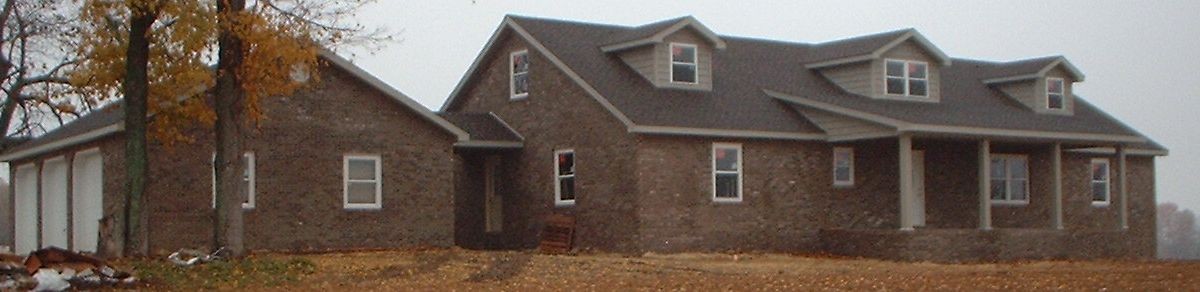

Mac,
   Looks like you have a great start on your house. I'm 14 months into mine and almost finished now. It's been alot of afternoons and weekends, but i think we've made pretty good time for just me and my dad on a part time basis.
   From this point looking back, I would do it over again in a heartbeat. We have learned new things just about every day. Some of them the hard way. I think a person appreciates a house alot more when they understand exactly what goes into building it.
   Greg
Attachment: 11-13-07 cropped.jpg

That's awesome!  Looks great too!  14 months is not bad AT ALL!  I've seen homes in my neighborhood go up completely done by a "builder" that took that long or longer!  (and the specific one I'm talking about is quite a bit smaller than the one in your pic!)
