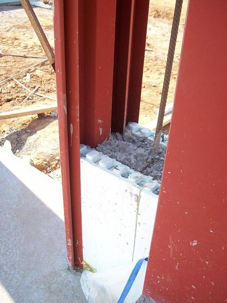

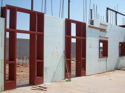

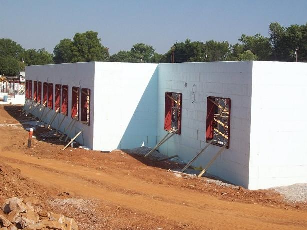

With regard to commercial ICF window framing, further attention to wall alignment of moderate to large openings also needs to be addressed. To obtain a true ICF wall, alignment of the eps panels and concrete core is key . Please view: Commercial Grade ICF Window Openings
The proximity of window openings is another concern. With multiple windows close together, ICFs have to be cut very short. Stala's wall alignment assists to minimize "snaking."
As for door openings, the sheer weight of hollow metal door slabs can turn into a maintenance issue within conventional bucking. Incorporating framing strength into the ICF concrete core is a much better option. There are pictures attached to this thread, including commercial door assemblies that are prepped to swing heavy hollow metal doors. Sidelighting, transoms, etc. are customizable / optional
-David
Attachment: Commecial ICF Door Framing Stala at Joseph Warren
Attachment: 2 TC Cherry Elementary and Stala classroom exterio
Attachment: 5 TC Cherry Elementary and Stala wall alignment -
