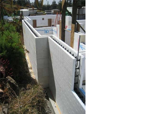

Here is an 18" bumpout, we had a 3" overlap between courses, cleated the whole way up with plywood.
We poured this wall when it was 14 feet tall.
