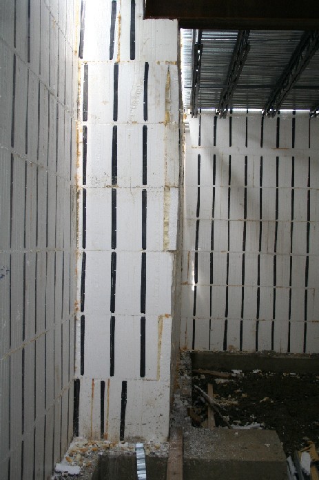

Also in my basement, I have a wall that is bowed inward because they decided not to use the ARXX corners because it was only a two foot offset.  I knew they should have used the corners and just cut them down.  Now I will have to frame that wall to hide the bow in it because the plaster will look horrible.

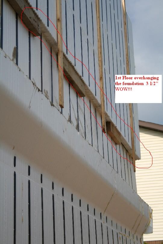

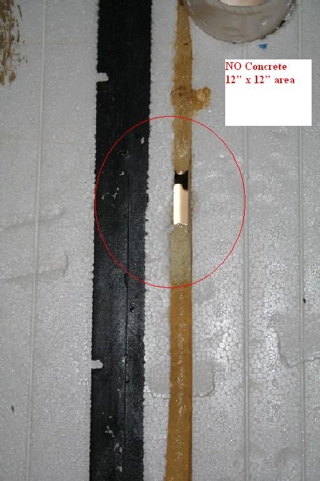

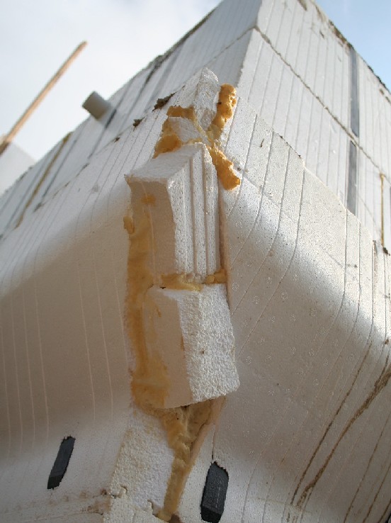

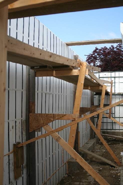

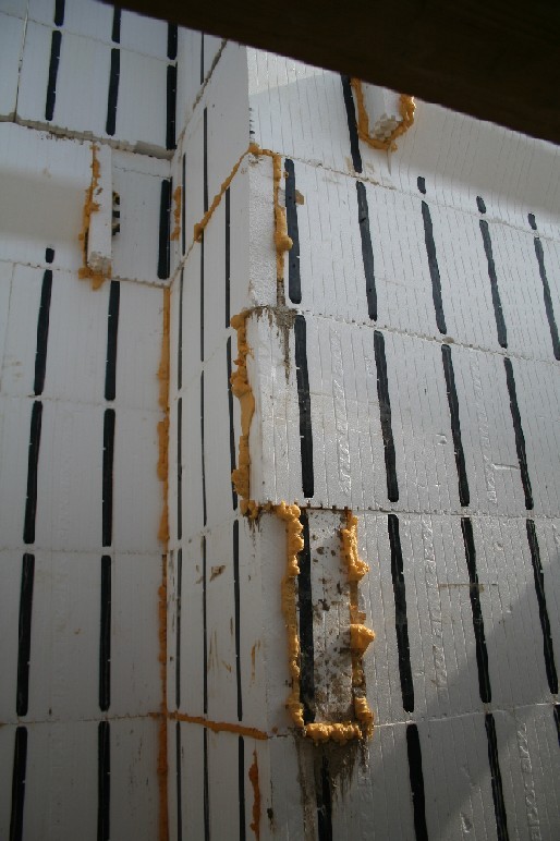

I am offically shutting this job down tomorrow based on the expert opinion of a Certified ARXX installer with 15 years of experience in the industry.   He was embarrassed for the industry that my house looks like it does.  He said if it was his house, he would tear it all day and start over with someone who really knows what they are doing and not pretending to know what they are doing.  Now I am left with the situation that I am the general contractor and I sub-contracting this guy who has been in business for over 30 years and has done about a dozen ICF structures but this is his first ARXX project and is not certified in the ARXX product.  I have about $30,000 in materials that I have invested into this project that would be lost.  I am absolutely sick about this whole mess.  I have a full set of pictures for anyone who would like to see them.  They are larger than this forum will allow me to post plus I have about 30 of them.  I did reduce the size of three of them to attach but I am not sure how they will turn out.  If you would like to see more just email me at [email protected].
Thanks......

I agree with your decision to shut down this project. Sometimes it is better to cut the current losses than to create new ones. I am also GC'ing my first ICF project and actually plan on doing most work my self. I have a very good "consultant" as well as factory reps that are willing to help. The "consultant" has a crew that will actually do the pour. I am in no hurry and am fortunate to have that luxury. I have chosen "TF" vertical ICF for various reasons.
I am familiar with ARXX and have seen several installs. This is certainly not a good way to start. I am not sure what agreement you have with the installer but from the pictures provided it appears substandard. ARXX is very user friendly and aside from the brickledge detail which can certainly complicate things, the install should have gone smoothly.
What footer size are you using? The latest PCA 100-2007 recommends about 36" wide for full ICF house (2 stories) on 2000psf soil.
Why is there a transition to the outside on the photo with the brickledge? I assume you using an 8-10" block for the basement and 6" for above grade?
It appears that the system has been poured from the concrete stains. Have you considered rasping and furring out the defects to "smooth out" the install? Certainly more than you intended but perhaps salvageable. If the engineer is OK with soundness of the project then this may be an option. What about rebar and reinforcement? Are you familiar with the schedule? Was it engineered? Is it verified to be in the concrete?
It certainly saddens me to see such an install.

To answer your question about the brickledge, we are using 6" block for the entire house.  The overhang is because the house is so out of square they are trying to square it back up again and this is there method of doing so.  If I let them pour it the way it is now, I would have 3" of concrete sitting on 2 1/2" of foam and a 1/2" of nothing.  The ARXX expert said this is not safe and would not want to be around when they would try to pour this wall.
Thanks for your support.

I have attached more pictures for your viewing pleasure.
