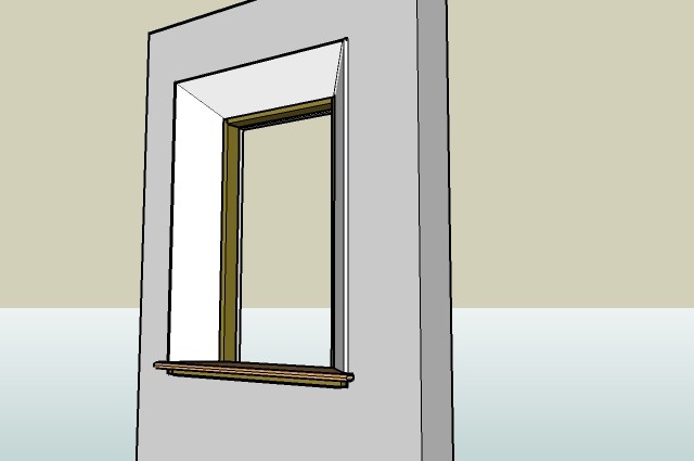

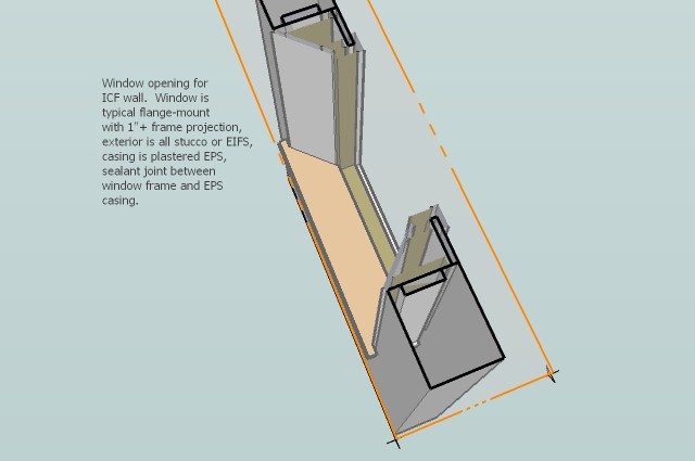

Can you read the note and see the detail on the image?  This shows a way to detail an ICF-wall opening to receive a conventional wood-inside and clad-outside (read:  Andersen, et al) window outfitted with the minimal "drywall return" jamb (i.e., about 3-3/4" wallframe depth, total).
The outside is stucco or EIFS, and the window gets a surround exterior casing of 1" EPS foam material, that gets plastered the same as the walls, and at the same time as the walls.
Inside, you get the "church window in thick wall" effect with 45-degree laybacks on sides, top, and even bottom if you want.
It is all in the details.

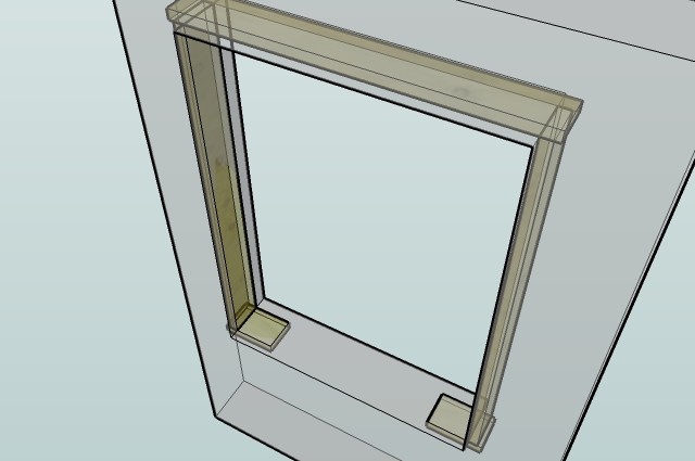

Here is some more info on how to do it.
In the first pic, the ICF opening is shown after the opening has its "for the pour only" bucks and bracing removed.  What is left is the continuous side and top embedded PT wood parts, and the two partials at the sill.
Those embedded parts will have been ripped to fit to the depth of the concrete core of the ICF blocks, and will have been studded with galvanized lagscrews head end into the concrete, so as to better tie the embedded wood parts to the concrete core.

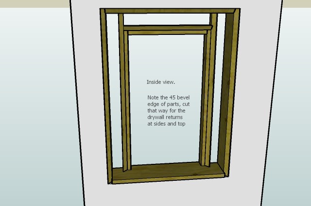

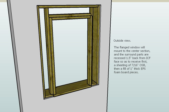

The next two pics show the 10-piece wood assembly that goes into the opening, which makes up your window structural surround, and your beveled-edge framing that makes angled drywall returns possible.
The outside gets sheeted in EPS for ease of exterior finish, and the spaces between the window surround rough frame and the beveled outside frame parts gets foamed with something like Tiger Foam, an easy way to do jobsite urethane cavity fills when you need to do more than just foam cracks around windows and doors.

The picture below shows the opening from the inside, with the window unit not shown.  You can see the 5/4 bullnosed finished sill part which has "horns" at its L and R ends to project out past the opening sides.  The finished apron trim part will go up under that sill and cover the subsill.  The drywall returns are in place at the three sides, but the wall drywall is not shown on yet.  This is out of sequence, rock-wise, but the pic is so you can understand the look and the parts.

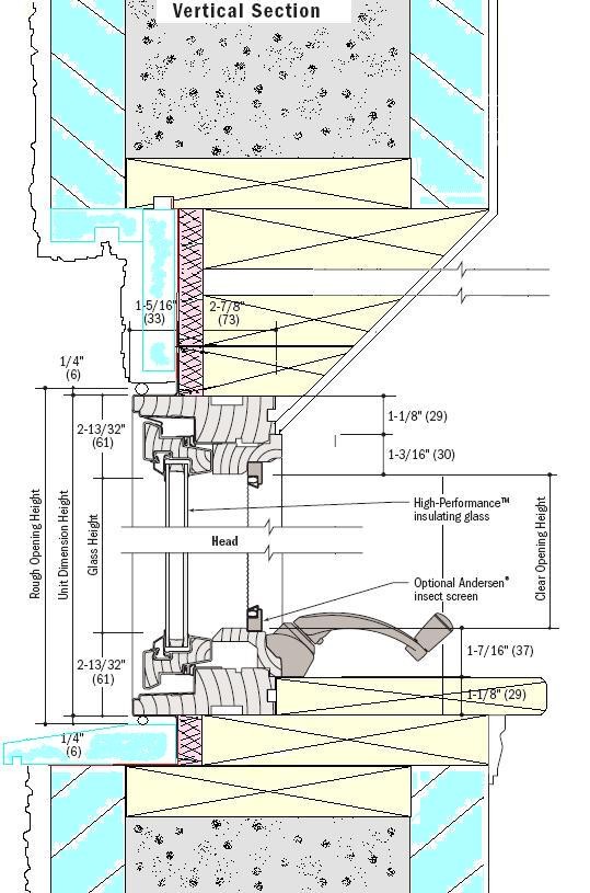

Ok, that makes sense. Here's a little detail I drew using paint and the Andersend detail for the vertical view.
I was thinking that I'd like to have the window recessed in a little bit from the outside, and do the sloped recessed like yours on the inside. What do you think about this picture? I'm still not sure where the flashing would go or what I need to do to make sure it's watertight and leakproof.
Attachment: Window Vert Detail ICF.JPG

The drawing is not to scale, but I will try to draw it out on paper and see what the dimensions come out.
My wall is 12.25", with 2.25" thick foam and 7.75" concrete core.

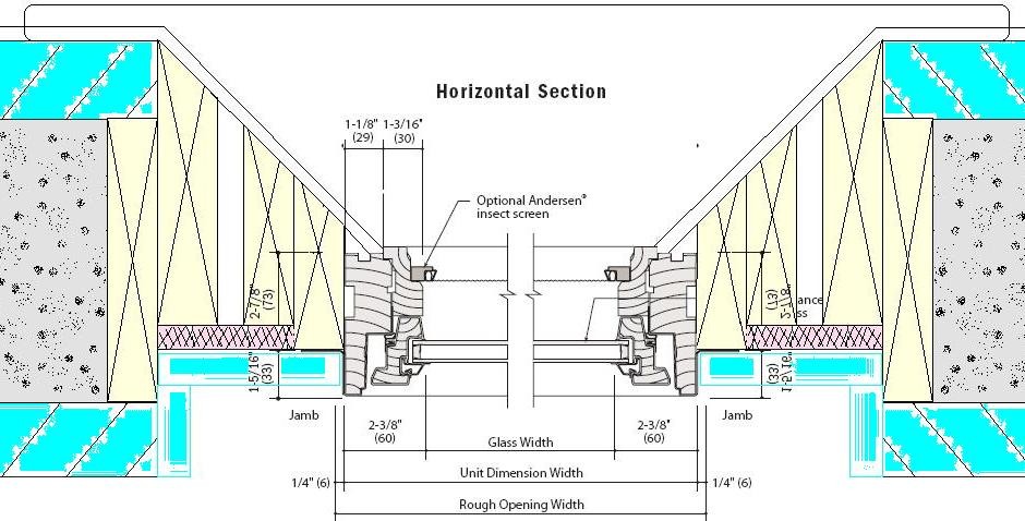

18 Aug 2008 12:41 PM
Here's the horizontal detail. Thank you so much for such a great idea!
Attachment: Window Hor Detail ICF.JPG

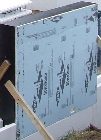

Buddy NewberryUser is Offline
07 Oct 2008 01:55 PM

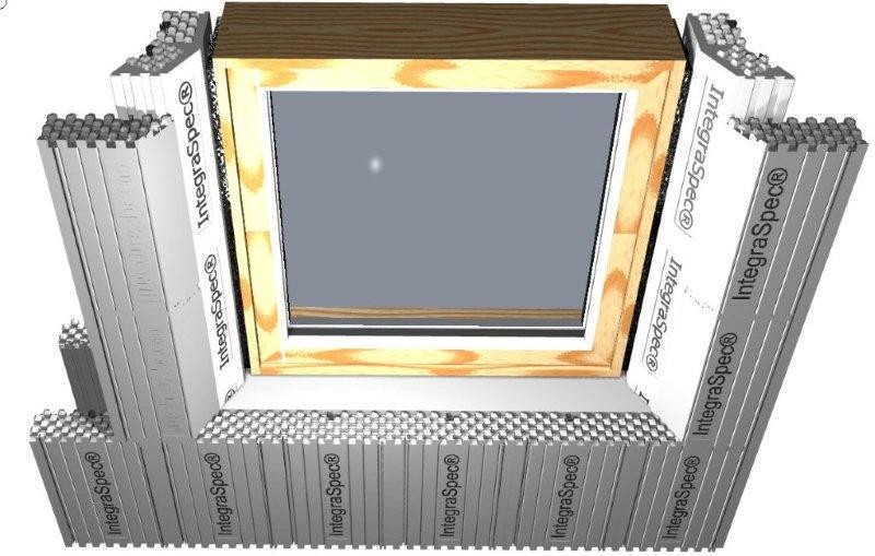

Woulf is right about the advantages of EPS bucks.
ICF's construction is all about thermal dynamics, and ensuring that the thermal performance of your ICF envelope is performing to its maximum potential. The way ICF's work is through a term called "The ICF EFFECT", insulated thermal mass and Air Infiltration Control. This term refers to the dispersion of the earth's energy throughout the ICF structure. Four feet below our feet the earth's temperature is 55 degrees. In considering the fact that concrete is a thermal conductor this temperature of 55 degrees then radiates throughout the footings and continues up within the concrete core of the ICF wallsystem. Concrete does not have an R-value, but when it is super insulated between two panels of EPS type 2 a term called "R-Performance" comes into play. The constant temperature of this concrete core repels both the inside and outside temperatures from travelling through your ICF structure resulting in award winning R Performance. The R-value of a home using conventional construction methods is ensured through the contractor's meticulous attention to the envelope tightness and performance, he may be using R-20 insulation but it is up to his expertise to ensure R-20 perfomance. In ICF construction the performance of the envelope is ensured by the product not the contractor.
I went on this tangent to illustrate the importance of having an insulated bucking system. If your RSO's are not insulated, the thermal dynamics of your ICF structure have been compromised. PT wood and other non-insulating bucking systems create a thermal bridge across the system, and at a point where outside temperatures are most likely to penetrate; at your windows and doors.
There are many different products of insulating bucks on the market and most of them perform on the same level. I would recommend IntegraSpec's bucking system simply because it has a furring strip within it to make installation of windows and jamb extensions much easier. As well, in noticing some of the pictures attached above in this forum, IntegraSpec also has a new patented insulating bucking system that has a 30 degree bevel on it giving you the Church Window look while also insulating your RSO's. Finally, insulated bucks are oftern cheaper per lineal foot than PT and easier to install in most cases.
Buddy Newberry,
Attachment: Santa FE Win Ass1.jpg

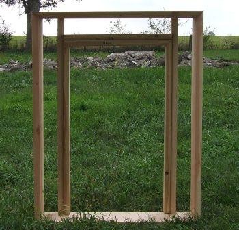

FarmboyUser is Offline
Posts:356
19 Oct 2008 12:12 PM
I would be interested in seeing some photos of your bucking if available. Thx Dave
Boontucky-girlUser is Offline
Posts:250
21 Oct 2008 05:05 PM
Here's some pictures that I have. Basically, our ICF wall is 11" thick, and we built the outer frame to 9 1/2 inches wide, and added half inch of sheathing and 1" of blueboard on the exterior. We covered the whole window and when it is time to install the windows, we will cut the sheathing and foam along the interior of the inside frame and the window flanges will be installed on top of the foam.
Attachment: Window2.JPG
Attachment: Window.JPG
