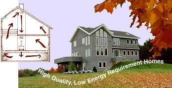

Two pics are attached, one showing the ducting mostly in place prior to slab mass being poured, and the other shows a typical house with a diagram showing the heatflow concept.

The system looks like a knockoff of the Legolett underslab heating system. But with a lot of added bells and whistles. This type of system works, quite well apparently. I have no personal experience with it myself.
Bill Chaleff, a SIPS architect whose writings appear on this site, has developed a similar, simpler system that he has used successfully. Check out his article.

The pics look like the area underneath the house is being used for an "energy storage/distribution system". A clever idea that, with proper thinking in terms of thermal dynamics and its regulation, can be improved upon.
