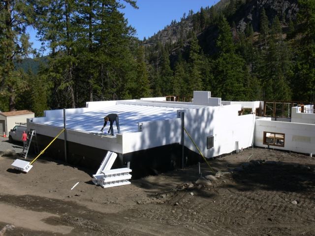

Good to hear from you, thought the summer was taking its toll and you had gotten lost in the vortex of the building season.  We too are nearing completion of an extremely complicated 3 story ICF building 72 % covered in earth with concrete floors concrete walls and a concrete roof.  We used the Logix system for the walls and one of the parent companies for Logix, Beaver Plastics, has a floor system that we have extensively tested and is ready for prime time.  I believe it will be anounced at the ICFA show in Portland the end of this month.  Here is a picture of the 3rd story garage roof being placed.
ICF Contractor
Attachment: P1060638.jpg

Great photo, I love to see advancement in ICF and acceptance.
I can't figure how to add a photo. Any help?
