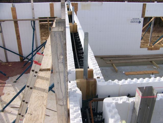

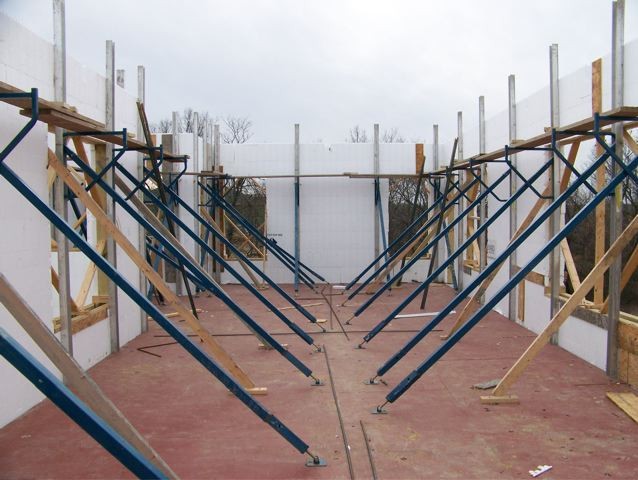

We recently finished an ICF home with both 6" and 8" T's in it using the Reward block. We have used the 6" on many occasions before without any trouble. This particular project was the first time using the 8" T and we encountered no problems at all.

roach, Do the reward Ts allow the ties to line-up and the seams to stagger by at least 6"? Why do you have plywood on the back of the T?
Off topic are those straps to hold down beams in beam pockets?
s22roachUser is Offline
23 Jan 2009 08:55 AM
Yes, all of the ties line-up and the blocks stagger one foot. I have always put plywood with a turnbuckle at my T's just as a precaution. Plus, it is nice to be able to plumb the wall at the point of intersection. The straps are for wood trusses that are going to support the SIP roof.
