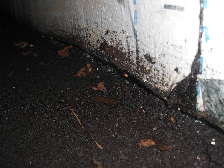

We just found mould in the basement our new ICF house (not yet occupied). We've ripped out 20' of drywall so far.
The cause seems to be the asphalt driveway we installed for our neighbour (we damaged theirs during construction -- long story). The driveway was run right up to the edge of our house, however, despite the builder's warning to stay away from the ICF.
It certainly looks (completely obvious to us, anyway) as though the asphalt melted through the water barrier and enough of the ICF to allow water to follow the seams through the concrete and into our basement.
The driveway guys are saying their hot asphalt isn't hot enough to melt through and the thousands in resulting damages aren't their fault. They, in fact, say they've put 'thousands' of driveways beside styrofoam without a problem. (Of course it's not the styrofoam that's the problem, it's the moisture barrier, but anyway).
Does anyone have any experience with these two materials coming together? Is it, for example, common knowledge that one can't put asphalt beside ICFs?
In case it's important: These are Nudura ICFs with 2.5" of insulation and Nudura's own water barrier.
Thanks, Colin.

Asphalt is not only hot, but petroleum based. Petroleum eats EPS. To demonstrate, take a scrap block and pour gas or concrete sealer or anything petroleum based on it and see what happens.

I'm not sure if a chemical reaction is involved but a closer look this evening confirms heat was at least the primary factor. They melted through the hard plastic dimple wall too! (It was an extra protection for the thin membrane against a sharp stop piercing it, etc.)
Nudura has now confirmed "of course it would melt it" as well. Hope the driveway guys agree!

Asphalt when delivered is close to 350 degrees F. It will definitely melt EPS and the membrane. Unfortunately, it seems many asphalt driveway contractors do not know anything except how to make asphalt look pretty! And details are rarely passed down to the crew! It's actually a wonder that they did not damage your walls with the roller!!!
I sure hope they were not paid yet. Take lots of pictures for your attorney and the judge. Sometimes, a letter from your attorney will prompt the contractor to repair the damage, especially if the contractor is given a specific date to make restitution by, and if not you will hire a contractor to repair it and take the cost off his asphalt bill. If the asphalt contractor ignores it just go ahead and hire someone to repair it. If he threatens to sue just say "Go ahead. I can't wait to show the court what you did to my walls!"
Make sure to include your foundation contractor in the letter and your home builder; especially if he was in charge of the construction.
DO NOT PAY ANY OF THEM UNTIL THE PROBLEM IS REPAIRED!!!!!

Driveway guys were paid 5-6 weeks ago when they did the job. (The water was seeping behind the drywall for that long.) We gave them the option of coming down to see it, but they had no interest. (After much berating they agreed to come "Friday or maybe Saturday" but we couldn't wait. We have to complete the build (we move in in 17 days) so the repairs have now begun in earnest. We have lots of pictures, video and the heavy plastic dimple wall they melted through before getting to the water barrier and ICF block.
I called an engineer who's working on the project and he just said "You don't need an engineer to tell you that's melted. Melted, is melted. The asphalt was actually paved INTO the block so what else would do that?"
