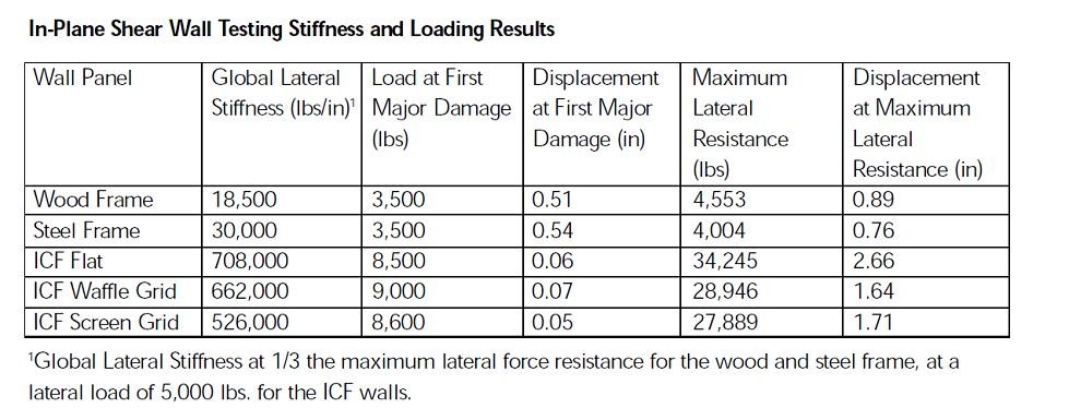

Posted By rykertest on 08/19/2009 3:00 PM
I've seen weblock and IN MY OPINION, you can get a MUCH better icf block for the same price. Thats what we charge for Nudura. I would encourage you to look at Nudura, Reward and even some of the other ones. Arxx or Fox Blocks would be a wiser investment IN MY OPINION. :)
I dont see how you can say they are better when the ICFs you just mentioned do not even do the same thing...
What do you mean by better? 10% stronger? weblock uses so much less concrete.... you pay the same for the forms but half as much for the concrete and lose very little in strength...
take a look at this.... if strenght is the issue - why not go with a 14" cavity... lol...
why do you guys make strength an issue when it comes do different types of icfs?
so silly.... compared to wood frame or steel frame these things are bunkers...
so yeah at $12 per square foot - you are good to go - that is a good price.

lol...then use it then. A I stated in my last email this was MY OPINION, you disagree; fine. I'm not bashing a smaller icf company. If it was a good product I'd use it. It isn't. Sure ues less concrete and get a weaker wall, and what about labor? Of course it's better than a stick built wall, I never said it wasn't. And what do you mean they don't do the same thing? They are to used to build a home right, not fly to the moon. lol This grid technology is in the past for a reason, it's inferior. Why do you think that the progression of ICF's has been AWAY from this style?

We install a screen grid for under $8.00 for wall, concrete, rebar, & labor only. Footings add approx. $1.00 SF on 8' walls, and H2O adds something more depending on the product chosen. Ryker charges $12 SF and defends his wall system as I would if I had to charge that much. Defense and opinion are just that, the opinion of but one person. My one person opinion finds the opposite positives of Ryker's negatives. The screen grid we are using has sufficient attachment points, concrete consolidation is simple, and reinforcement is simple. True, there is less thermal mass, however replacing concrete with EPS is not a "bad" thing in the insulation and R-Value world. Sixteen foot lintel spans can be created with eighteen inches of height if one uses simple creativity and goes beyond the constrictive building codes by adopting the manufactures tables ( approved by code if according to ACI 318). Using the manufacturers engineering is not so hard to do. Lower ultimate strength is a moot issue if the wall meets or exceeds code &/or engineering specifications. One need not over build at a higher cost in order to more than sufficiently protect the occupants from nature's forces. Requiring or preferring concrete in a monolithic solid would be similar to having wood or steel in a monolith rather than in a beam and column configuration. This is an engineering thing, to design the safety and strength into a structure. The suggest that other than solid concrete ICFs are not strong enough is a worn out and invalid argument. It is honorable of Rykert to point out that the not solid concrete ICFs use less concrete, less labor, and have higher R-Values, but it seems apparent that the reasoning for the overall opinion is somewhat flawed. Unless one prefers to pay $12 a SF instead of less than $8 a SF - 50% more.
