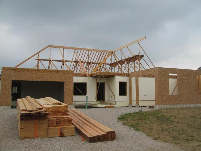

No, the gables and roof are stick built, and so are the garages which have conventional poured concrete frost walls.  Those decisions were driven by my overall project budget.

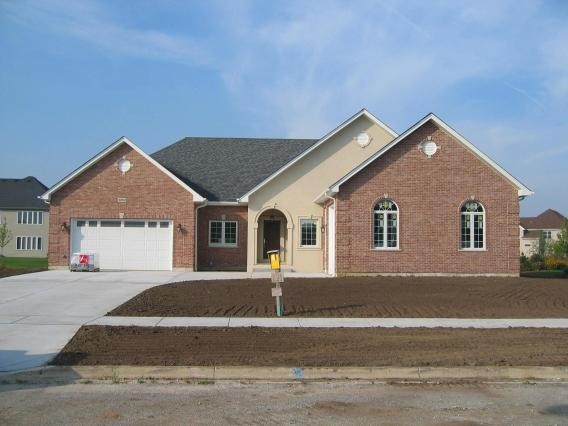

Beautiful house! How do you like it so far? Welcome to the ICF homeowner club. :)

Real nice place. Never have I seen a double garage but separated like you did. Almost didn't even notice the one to the right, good idea. That way the garage doesn't look bigger than the house!

Thanks.  Also, the garage door is 10' high to accomodate my 22' Class B motorhome.  Every other design made the garage door stand out and spoil the appearance of the house.

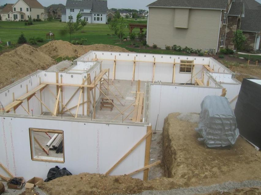

The pour went extremely well.  I was cautious enough to hire an experienced TF System installer to check out my bracing and help me with the pour of the foundation.  He charged a flat $500 for doing that.  We used a conveyor, standard wall mix (3/4" aggregate) with a 4 to 5" slump.  Three lifts to fill the 7.5" x 10' forms.  We had no blowouts; not even a bulge in the forms.  We had to increase the slump to get the concrete to flow under the steel basement window bucks (no slot in sill to inject concrete) and, still, the forms stayed strong.  Couldn't locate a 1" vibrator with an 8' whip for the life of me, so we ended up consolidating by use of a rod and hammering the sides of the forms.  All indications are that worked fine.
On the above grade (5.5" x 9') walls, I used 4000 psi concrete, pea gravel aggregate, and a pumper.  To save money, I hired a local concrete laborer to help with the pour (his first ICF pour.)  I told him what to do.  Concrete placement went even smoother than the basement walls.  The pumper operator could control the flow through a 3" nozzle (no double 90 was used.)  The pumper operator said it was one of the easiest ICF pours he'd ever done.  Three hours from start to finish.

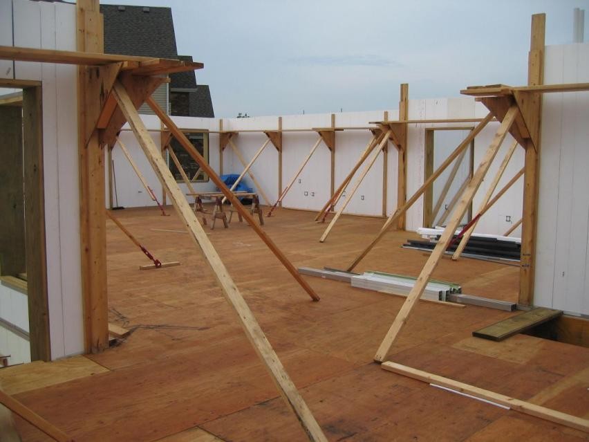

TF System forms are really easy and fun to put up.  Not much bracing is called for.  Rebar is easy to put in, tie  and inspect f you put the inside panels in last.  Most of the work is done from the ground.
I didn't keep accurate records of the labor needed to put up the forms.  It took six days to erect the foundation wall forms and 10 days to do the main floor walls (lots of window and door bucks.)  Not very fast, but I remember that the weather was in the 90's most days and we were learning as we went.  It also included inserting PVC conduit in the forms and erecting our homemade scaffolding.  I estimate a total of about 350 to 400 man-hours, 50 of which was for professional help.
