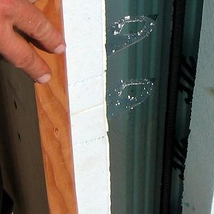

I've developed a way of putting wood bucks in which I think is better than anything I've seen.   Using a wood buck, you cut strips of foam to match the inside dimension of the wall (block) cavity.  You can use block scraps or just rip strips of EPS or XPS.  This foam will end up inside the edge of the ICF blocks at the window (or door) opening and will be installed between the buck and the concrete.  This gives you a thermal break as well as a moisture barrier between the wood and the concrete.   I have developed some (Patent Pending) brackets which slip through this foam layer, hold it in place for the pour and embed into the concrete wall, tying the buck to the concrete.  The bracket is fastened to the buck with self drilling screws.   If the attached drawing and pictures come through you can see better how this works.  So here's the deal.  I am looking for a few people who would like to try some prototypes. Please e-mail me ([email protected]) if this interests you.

03 Mar 2008 12:40 AM
Just to make this more clear, here is a picture of the block being stacked to the buck/ thermal break/ bracket assembly.  The foam attached to the buck ends up inside the edge of the wall cavity.

dbollerman...do you take credit cards or do you want a check sent? I would like a few to play with and see, couple questions, what's the difference between your clip and just attaching to the web of the block, then on the back side instead of cutting the web flush with the block leave it on to be held by the concrete? Hows the time factor been with the crew in installing? Are you able to drop two #5 through the holes and is engineering satisfied with that as your double #2's around the opening?

The difference between using these and just using the web on the block scrap as you describe is strength. These are 16 ga. galvanized steel. I have only supplied these to a few friends so I do not know how fast a professional crew will get them in, but they have gone in very fast.
I think what you are suggesting for the re-bar is that you install them so that the holes line up at the center of the cavity. I recommend that you install the clips to the edges of the cavity. The embeded sections of the clips are angled inward such that if you set the clip to the outside edge of the wall cavity the embeded openings will be sitting about 2" into the cavity. If you alternate them up the sides of the buck and slip your opening reinforcing re-bars through the holes this will give them a nice spacing and hold them in place for the pour. This method will also help to control any warping of the bucks as they dry.
