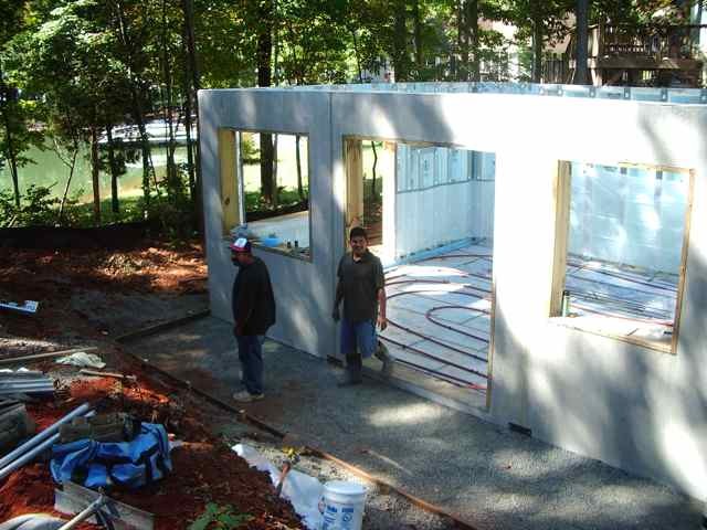

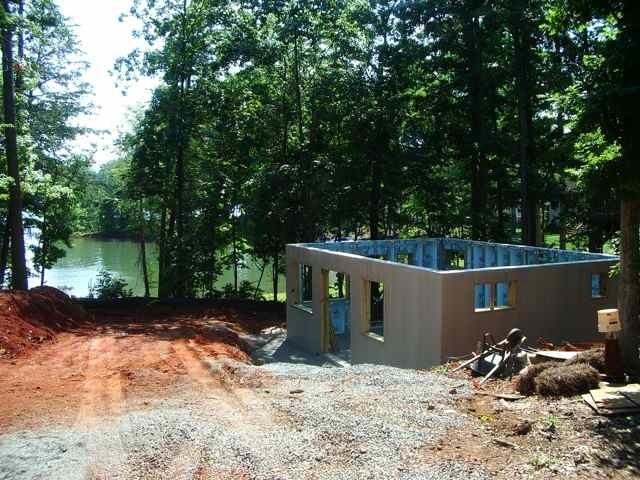

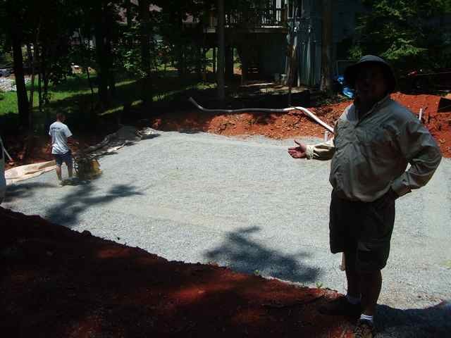

I am currently building a cottage using superior walls in NC. Its a box 20 by 30. I used my skid steer and dump truck and one day of my buddys backhoe[$400] to prep my site and brought in 40 plus yards of 78m [$1100]washed gravel filling my excavation to a depth of 16 to 20 inchs tamped every 5 or 6 inchs with double french drains, lot has a ten percent grade with walk out basement. My cost for delivered and installed walls, including crane was less than 10k. 100 linear feet. I spent less than $12000, walls are ten feet high. Seems like a good price to me. I love the idea of icf but they are not real common here. The blocks i looked at a couple years ago seemed really steep and i had seen this old house use the superior walls as well as the mag Fine home building. I am very happy thus far, water will never reach my slab, and after i use dimple material and waterproofing like s. walls instruct i will have a dusty basement. Seems to me if my living depended on competing against something i would learn everything possible about that product. Sorry to run on but there were so many false statements about superior walls i had to reply. And to Wolf, Have you ever even seen a superior wall in person. I doubt it so it migh be better to share information on this forum based on exp or observation or at least direct relaying of info. Alot of people like me depend on these forums for education.

You don't have footings. If you have water outside, you will have it under your basement floor. You added water proofing. You don't have much concrete or insulation. I could have built myself a 1000 sf of ICF walls for 10k. I am sure your walls will work out fine for you, and are better than a lot of building methods but ICFs are superior in every way that I have experienced.
