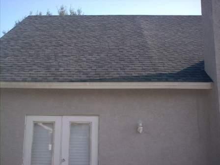

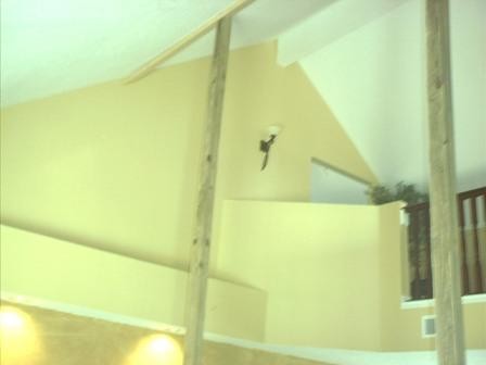

Hello
We built a Hip Roof using steel hip walls....
The roof itself was 6inch double sided 26 gauge steel panels.  R43 insulation factor.  We had to cut the panels for size.
We eliminated the Roof Trusses by doing this...
John
